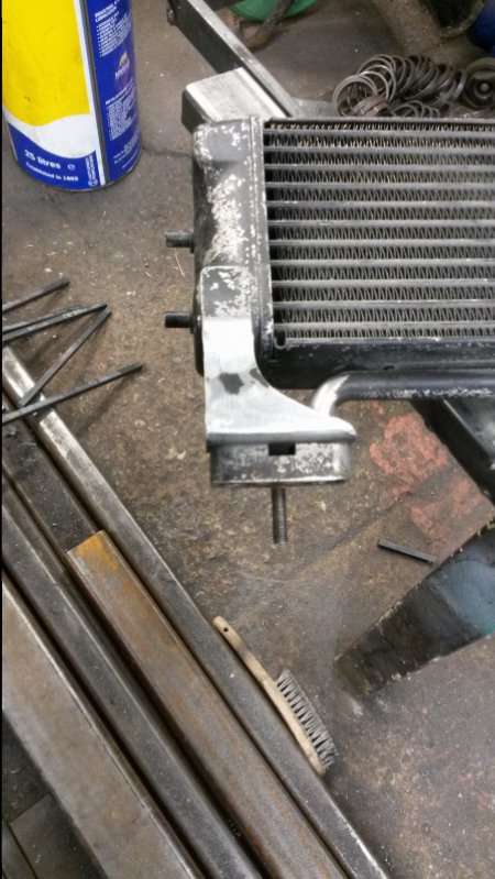

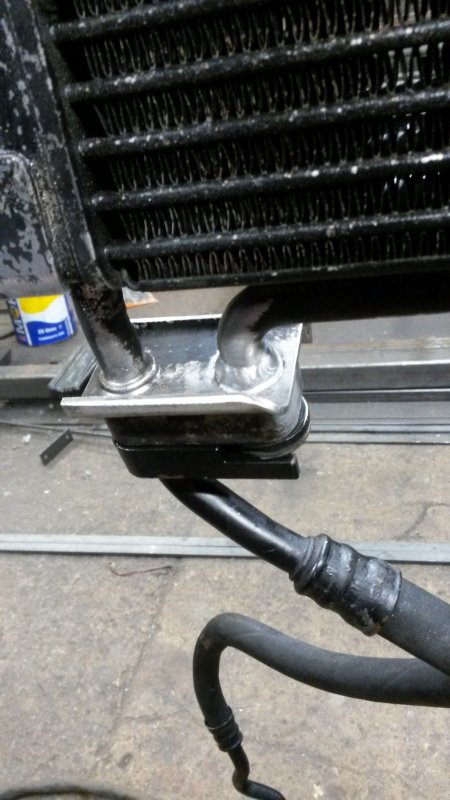

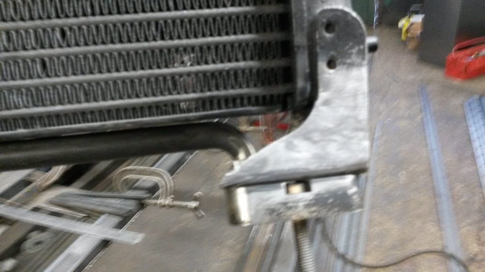

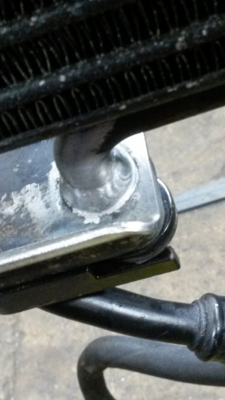

This is an Oil cooler, had a leak on the pipe , i had to cut away the support bracket to get at the pipe to weld it , it was full of oil , managed to get a weld around the tube and it held at 2 bar , just got to weld the brackets back on job done, 85 amps AC , 20 cfh not clean enough really but it worked out ok
