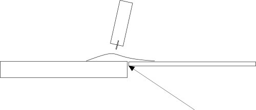

On the above page, foot of, it describes welding thick to thin steel.
Im trying to weld 3mm 1 inch box to a steel oil drum end....... not with much success due to my newbie style.
My question relates to "Strike an arc against the thicker sheet and get a weld pool going, then dip across into the thinner sheet and immediately back to the thicker sheet."................. (i have attached a crappy drawing to illustrate my thinking)
Where i have arrowed in the drawing, the dip or push of the weld puddle from the think metal over to the thin will stick the steel but does it penetrate? do we have fusion of the two metals or is the weld sitting on the thin metal.
I know if i stay on the thin too long i will burn through (lots of practice has shown this). Im concerned that the weld may look good but is not actually joining the two steel sheets.
Any help appreciated, its just a newbie question, just worried that the weld pool being like lava is flowing over rather than through the steel as i would hope using the DIP it over there method.
