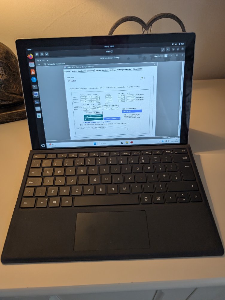

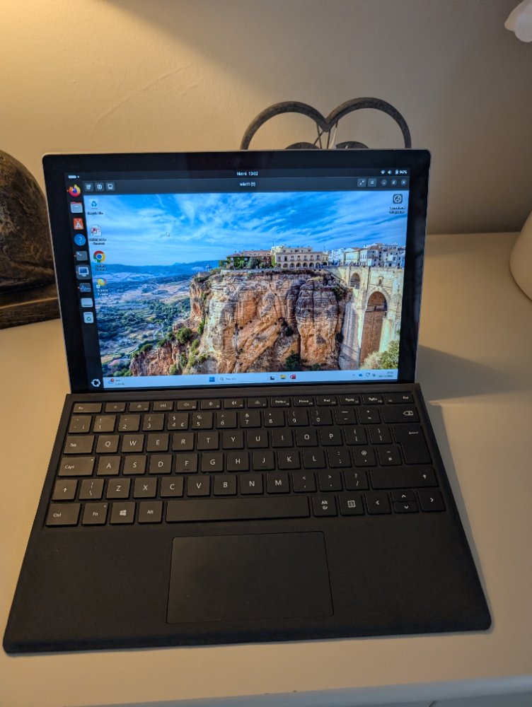

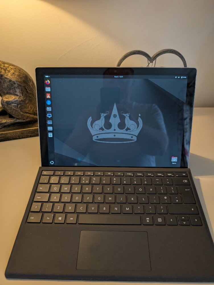

I bought a refurbished Surface Pro 7+ (A Microsoft device) 11th gen i5 @2.4ghz 16gb ram, 256gb SSD
This will be my work laptop
I chose this model because I like them and it's the highest spec without a cooling fan, the i7 has an annoying fan
Installing Linux was not the plan (yet) so I set it with Win 11 Pro, several hours of updates (without the optional new version)
Brought it home, turned it on to be greeted with a bit locker recovery request, and a non functional keyboard. Quick Google suggests a firmware (bios) update has caused this.
I decided not to reinstall Windows, this could be an issue
Ubuntu installed nice, using the Surface Linux Kernel has got nearly everything working. Due to a custom chip the camera don't work. This is annoying because chances are I will need to do a video call at some point
There is some software I need to use, there are no alternatives. This is government issued software. I tried Wine and it's (wrapper) variants and it does not work. This is because it is an access database that calls a suite of small programs. Wine cannot handle this. It also needs Access, Open/Libre office varients do not work, even on Windows. Defeats the object if I do a full Office install and I could not get the Access runtime to run under Wine either
I decided at this point I would try Win 11 in a virtual machine, I went straight to LXD and after a bit of messing about, I have it running at a reasonable speed!
Few pictures, showing Ubuntu, the VM and the hateful software
