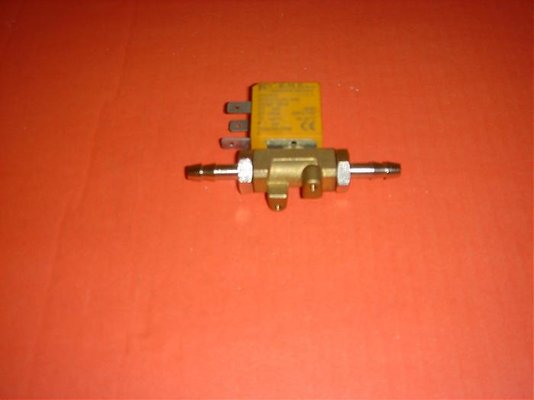

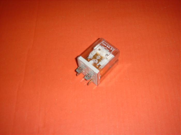

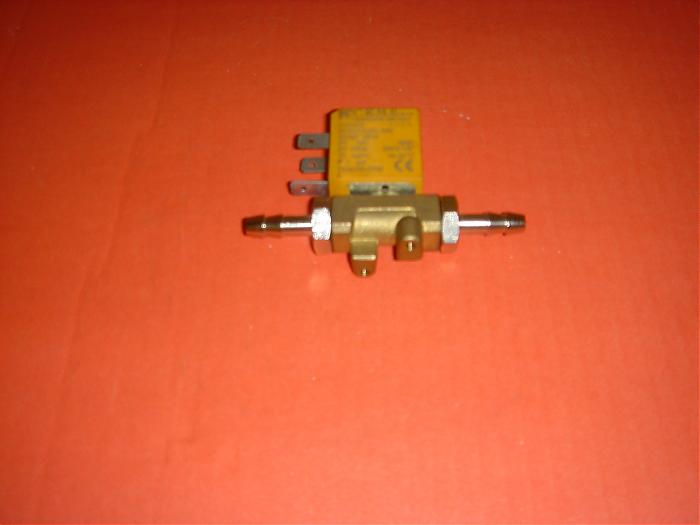

Both are activated when you press the torch trigger. If the gas solenoid valve was faulty you should still get wire feed but no gas. If the relay is faulty you won't get any wire feed.
This is a very simplified diagnosis as there are many other components & possible faults + different machines are wired differently. At least you now know what the bits look like though

Thank you for the pictures. I have not had a chance to get back to you until now - we have had a break from the welder! The relay is recognisable but soleniod valve is not like the one in the minimig. I will have another go at isolating the fault later. This forum is very helpful - thank you for your time.
