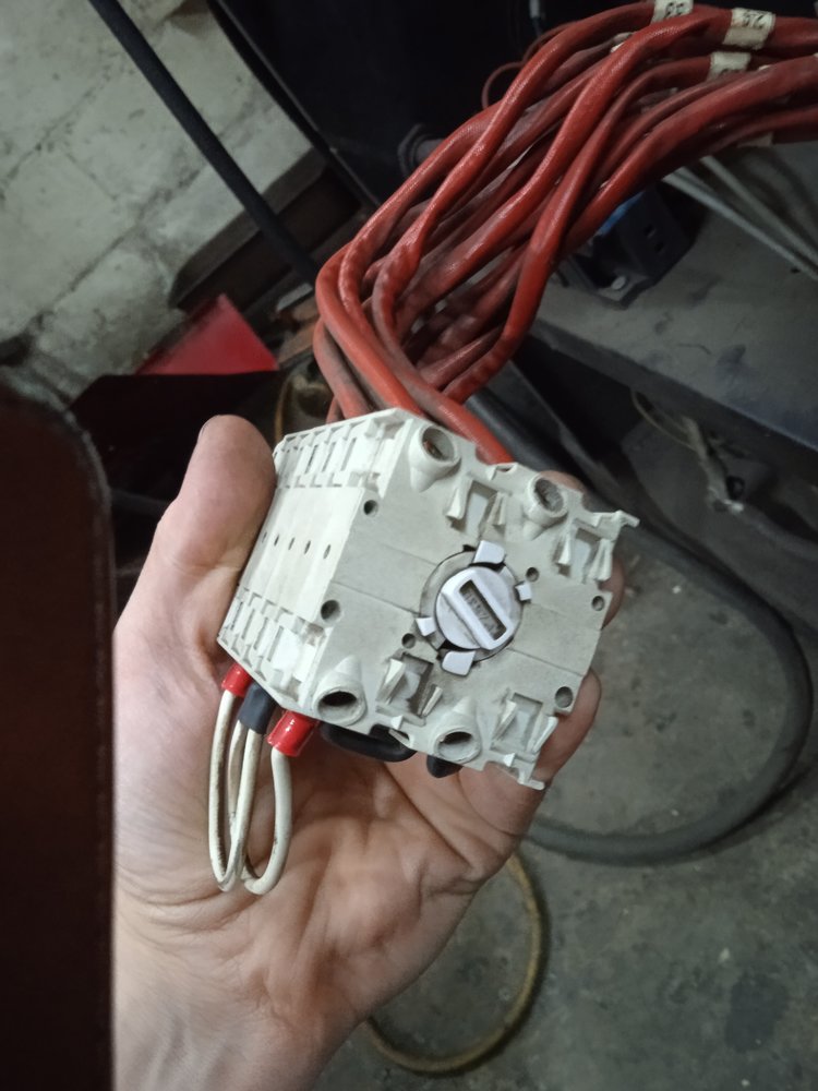

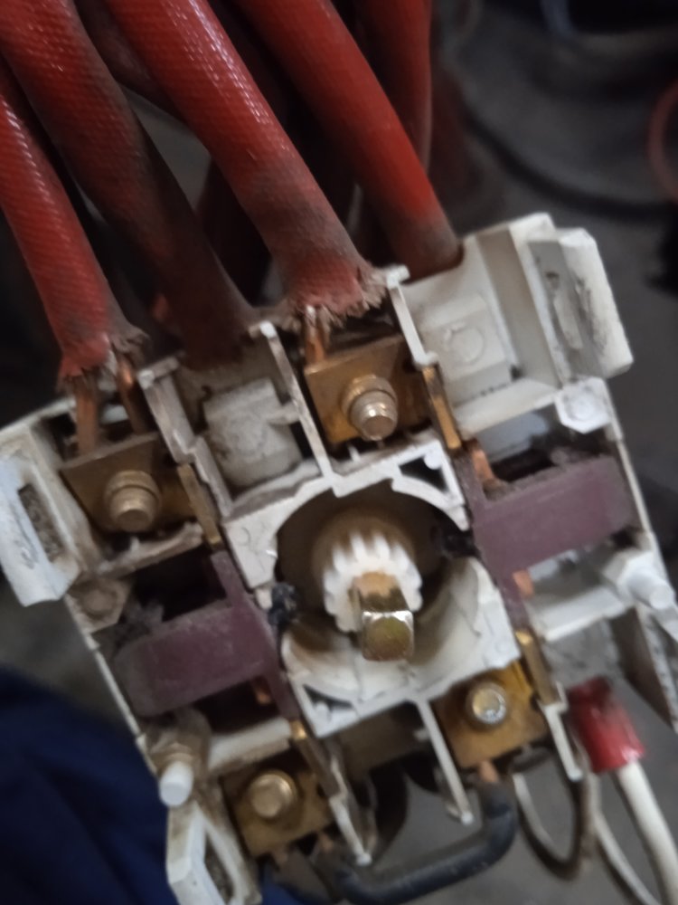

I have a Lincoln Compact 350 - I, The knob fell off the voltage selection switch , screws on from the back, so the switch came off seemed simple but it kind of granaded itself and after finding the parts that went flying the central rod that turns the cams isn't engaging the switches.
I think the cams have lifted up and are between the layers from what I can see.
Any advise for getting them back together ? I'm thinking of snapping the layers apart but am unsure of the clocking of the cams and also if any more parts are going to suddenly shoot out

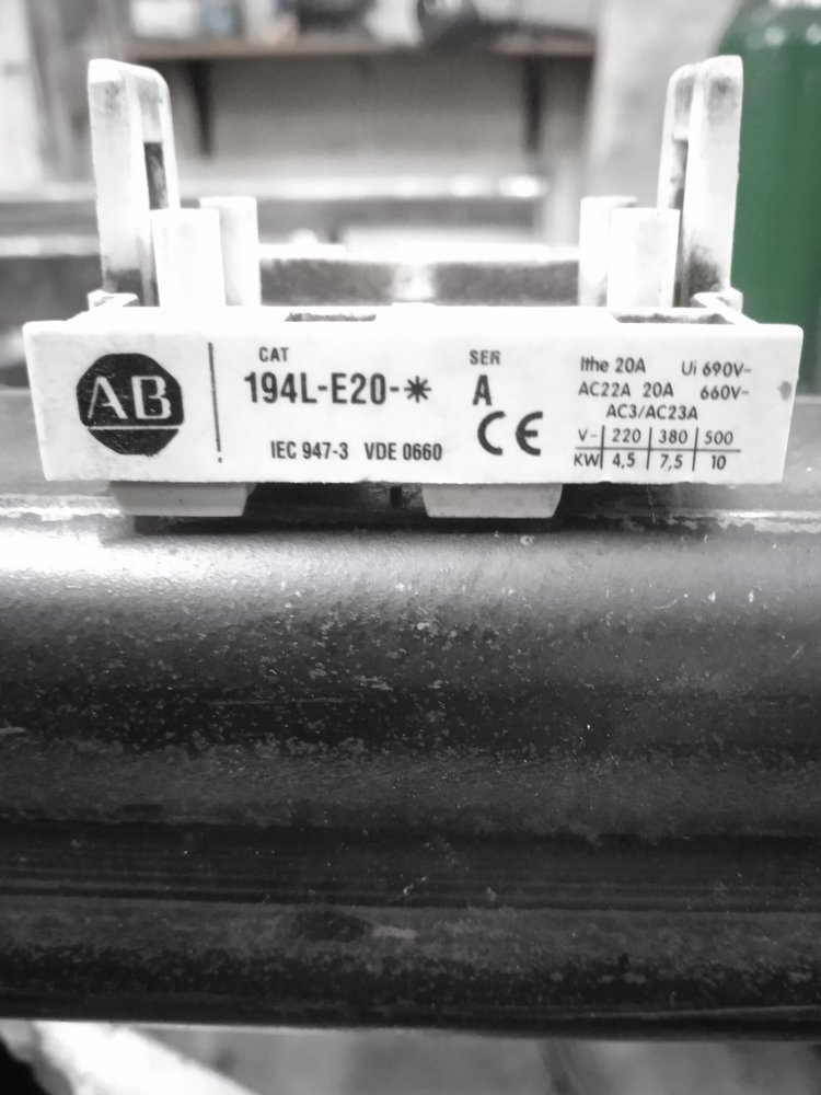

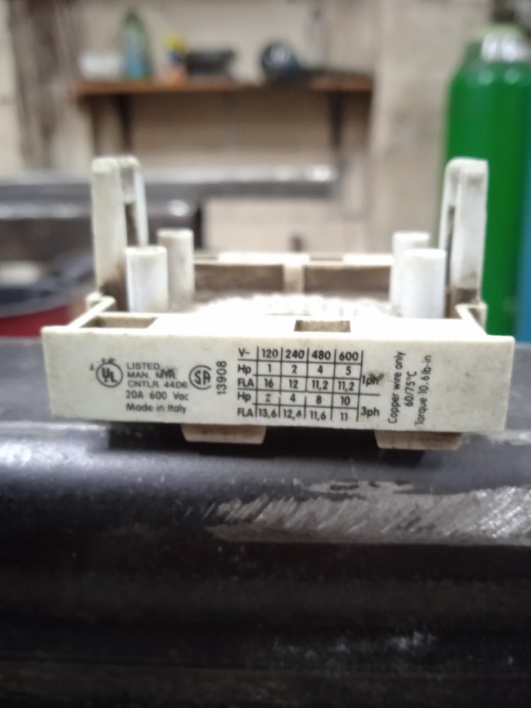

I could find a general pdf of the range but not with the switch combination that this one has.
https://literature.rockwellautomation.com/idc/groups/literature/documents/td/194-td002_-en-p.pdf

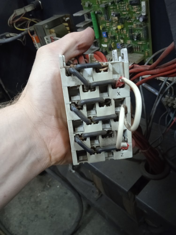

It's a 10 way (1-10) rotary switch and sets the voltage by configuring the transformer coils so has a lot of cables.
Some pictures for general amusement
Any advise on either disassemble/reassemble or sources for a new one much appreciated.
I have looked on the Lincoln site but it only lists a compact 185/220/250 which are single phase , the Compact 350 - I is 3 phase and the wiring is not like the others at all. It says Lincoln France on the data sticker, not sure if this is why I can't find it on the Lincoln website.
Stu.
