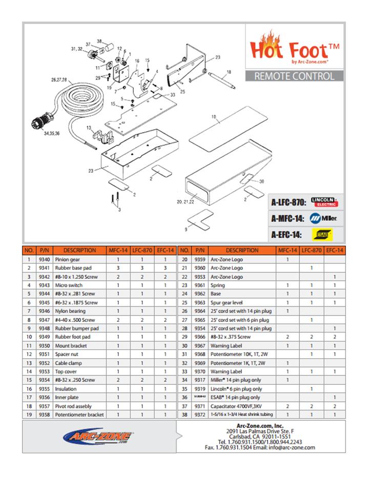

Can someone please tell me the specs on the 6 pin round plug that attaches to the machine on a K870 Amptrol foot control? (it has small print on the edge of the plug and i need those specs - MIL specs)

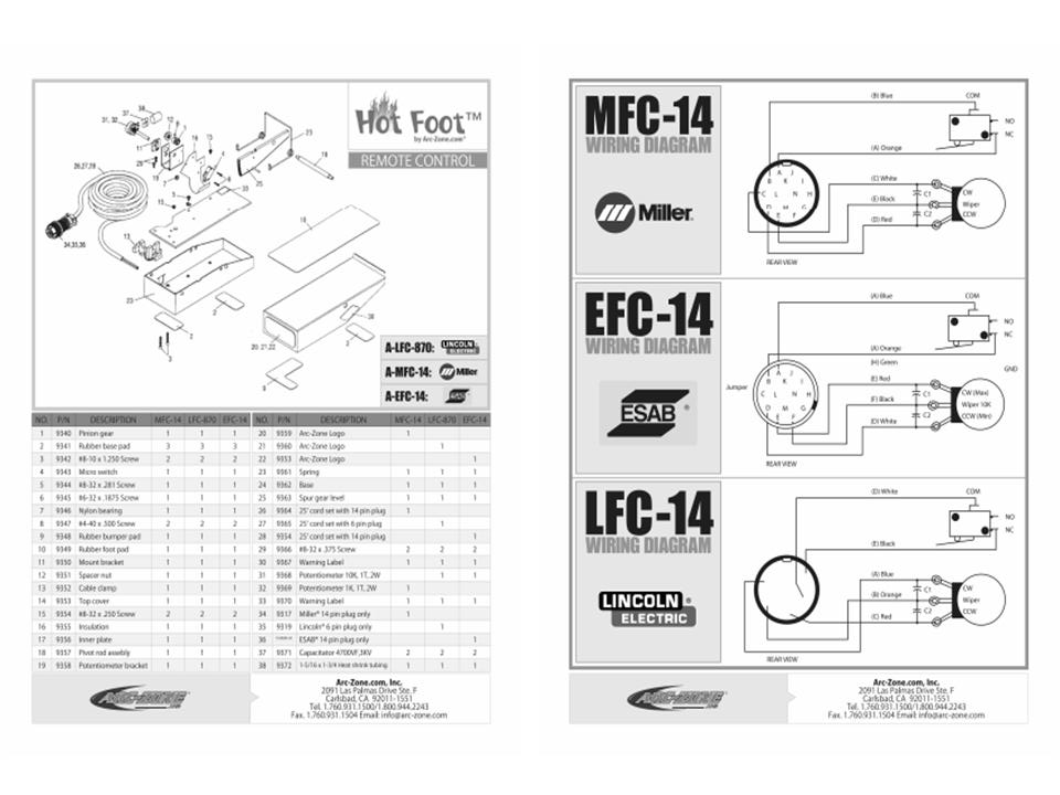

Also i have an aftermarket pedal wiring scheme (in attach) that mentions the need of 2 capacitors in parallel with the potentiometer (number 37 on the schematic), can someone confirm that please? A linc rep told me theres no extra components beyond the potentiometer and the switch but now i am confused. If you can help me i would be highly appreciative. TIA
