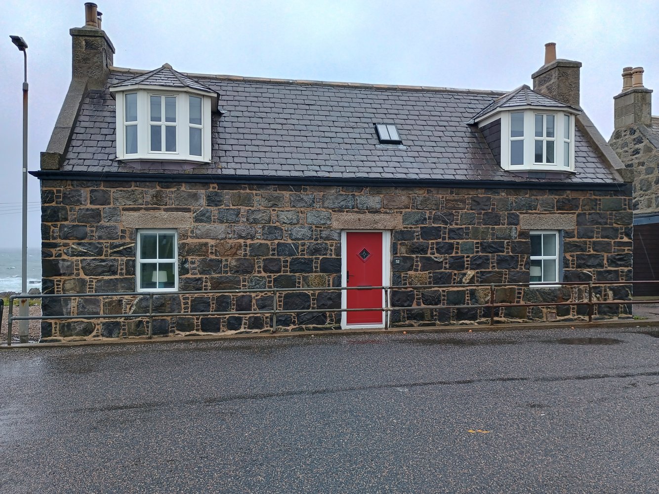

Thanks, will try 3:1 tomorrow.I just repointed my wall a few weeks ago, used 1 part NHL 5 lime, one part sharp sand and 2 parts builders sand, worked out well.
I’ll take a picture so you can see the colour as long as you don’t slag my inexperienced pointing skills!
It’s 5. Cottage is right on the North Sea in north east Scotland.Which lime are you using? NHL? 3.5?
I think NHL5 is reserved for very harsh environments, maybe that's you but otherwise a 3.5 might be sufficient...

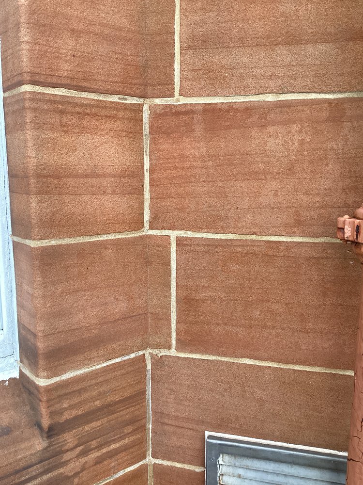

I had a load of stonework done by a local company that does a lot of traditional building work. They used NHL3.5, which is much more brown than the grey/white of cement/hydrated lime. And a very yellowy aggregate. The result was a nice tone without the grey of cement or much white limeyness. Will take a photo tomorrow if it helps.
Thanks. Not adding any cement. I’m just patching up the pointing that was done 5 years ago, maintenance rather than redoing it. It’s some sort of granite and was built from the stone on the sea front in front of the cottage. Cottage is older than 250 years old.Just to add that I wouldn’t add any Portland cement into it if it’s sandstone, my house had previously been repointed incorrectly with cement, it actually damaged it in some places, if driving rain gets behind it and freezes in winter it will expand and crack the sandstone, this happened on my house, it cost several thousands of pounds to get it all out and repointed in a traditional manner with lime mortar, luckily the company I got were able to replace the bits that had cracked off with a repair patch which when coloured is now barely noticeable. Cement is good on a new build not on a house built a hundred years ago.
Lovely character cottage!Thanks. Not adding any cement. I’m just patching up the pointing that was done 5 years ago, maintenance rather than redoing it. It’s some sort of granite and was built from the stone on the sea front in front of the cottage. Cottage is older than 250 years old.

I completely agree. Driven rain in exposed locations needs belt, braces and hat.I’m no expert, just have an old property which I did a ridiculous amount of research on, I was advised by a local company to use NHL 5, both myself and the OP live in exposed Scotland environments, all of the you tube videos I watched recommend 3.5 but when I talked to local suppliers they said NHL 5, I went with the advice of the local supplier. There’s nothing between my house and the coast, and looking at the OP’s house there’s nothing between it and the North Sea. Perhaps if you live in Birmingham or Sheffield 3.5 is fine, I would say just go with what’s advised.
