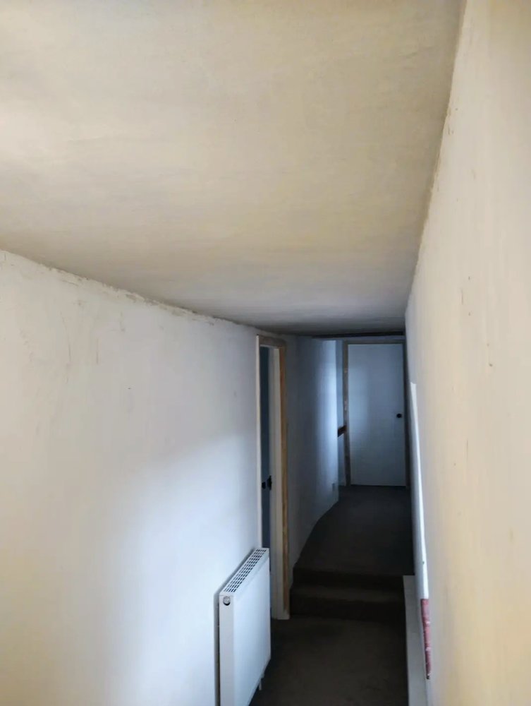

Yuo need a jack for all that.
A jack?
A jack?
My plastering guy. Jack.
