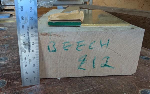

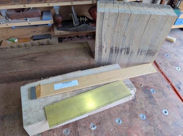

I had a rummage around and these looked like the best bits of material I had:
That big bit of beech to the right is really badly cracked, ruling it out sadly. I had thought (after only looking on one side) that there would be enough to take a slice out of it and use that, but on closer inspection I realised that it wasn't going to be much use for anything other than firewood. The darker wood at the back was something I picked up in an antique shop, sold as a mahogany lintel. That's a definite option and I'll almost certainly use it for the plane's handle, but the initial plan is to use the other piece of beech for the body (with a brass base giving it extra strength). This gives an idea of the sizes of the main bits of material:

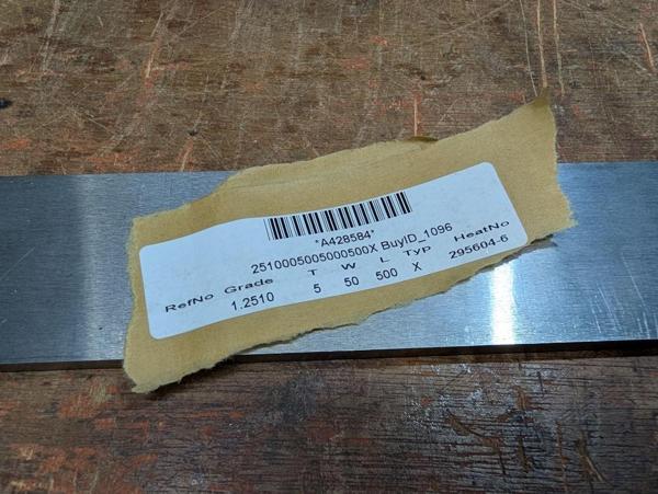

I'm aiming for a 70 mm body width, which means there isn't much excess material on the sides of that lump of rough-sawn beech. The brass plate is about 3 mm thick and 75 mm wide. I probably would have gone for a 75 mm body width by preference but I don't have any appropriate wood that is thick enough. The steel bar (gauge plate, also known as O1 tool steel) is 50 mm wide and 5 mm thick. I'm going to use that for the blade and also for a cap iron.

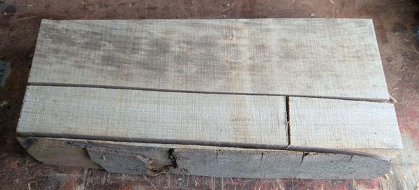

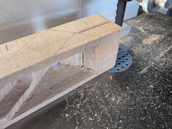

The first job (after spending quite a bit of time playing around with a CAD model, which I haven't completely finished yet) was to bandsaw the big lump of beech up:

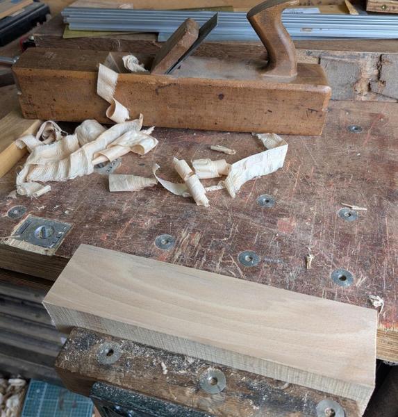

The base surface got planed flat with my wooden jack:

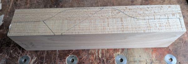

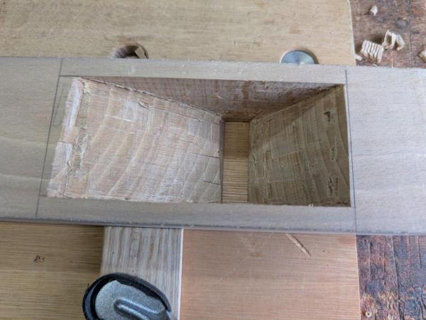

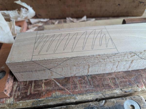

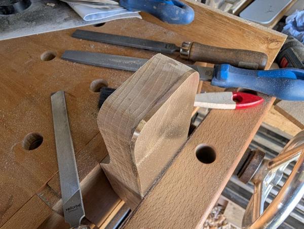

I've no idea why I did that in the vice rather than using planing stops, but it worked fine. I then very carefully planed down the sides so that they were square with the top, but taking as little off as possible to maximise the final width. I could then mark the shape of the body onto the side with a pencil:

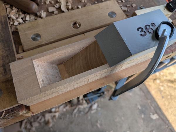

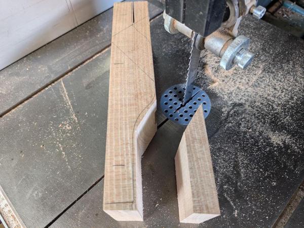

It's quite slim at front and back (25 mm plus the 3 mm brass thickness). Hopefully that will be enough for a strong enough body; I'm working on the assumption that the brass will help a lot with stiffness. Worst case I'll be thinking about a version 2 with steel sides but I'd rather err on the side of keeping the weight down for now.
