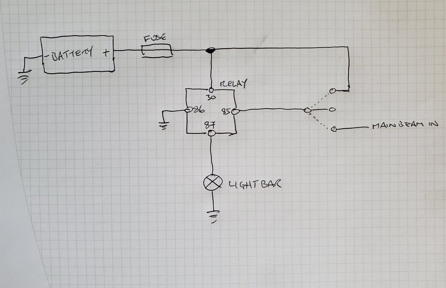

Hi guys,
I want to put a light bar on my camper but before i do i want to just confirm this is the right way to wire it all up.
I want to put a two way switch in so i can switch it to come on with the main beam headlights off the normal column stalk and then the other side of the switch i want it to just switch on independently of everything else, then the middle position of the switch is just always off.
I have knocked up a VERY basic wiring diagram (I am no electrical engineer) just showing how i think it should be done.
Please could you guys in the know confirm if this is the correct way to do it.
A loom with a switch comes with the bar and i just intend to change the switch and tap in from the mainbeam side.
The thing that concerns me is that this way it looks as though when its running without the Mainbeams, is the load taken through the Switch or does the trigger come back from the battery to trigger the relay and take the load through the relay and ultimately from the battery OR do i need to perhaps add another independent wire from the other side of the switch as well as the one to the battery. Apologies if this doesnt make sense. I have a bit of electrical knowledge but i just cant get my head around this bit.
Thanks in advance guys.
