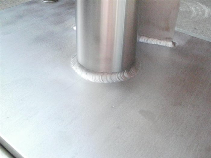

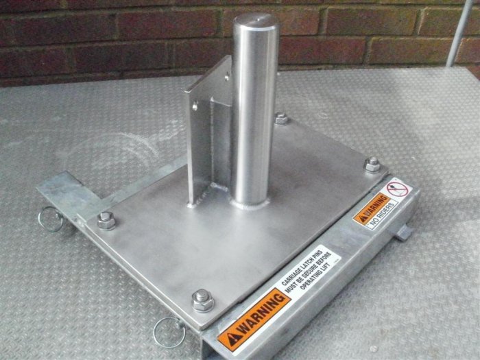

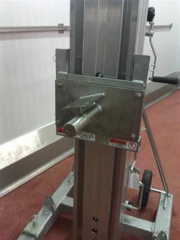

Made up this this week, its a modification to a genie lift carriage to handle a bearing housing of about 80kg on a meat slicing machine, made to someone else's drawing for a change, that pin is 47 mm dia welded to a 12mm backplate, all stainless of course,

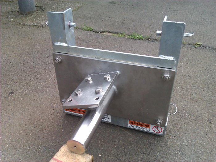

Only trouble is it didn't fit the housing, the designer didn't allow enough clearance between the pin and the plate, so I had to come up with a simple mod to allow some adjustment
Nice job for me, get paid to make it, then get paid to make it work.
