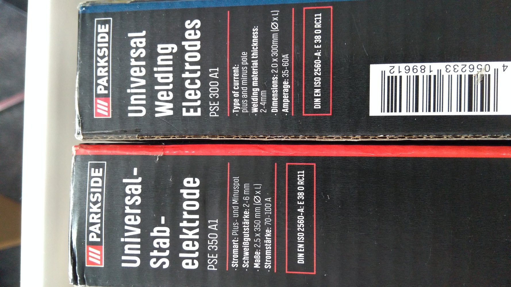

I spotted the Lidl stick welders in stock again, and 1kg packets of rods for £2.99 each, so grabbed a packet of each size. The bigger packet has no writing in English, the smaller does, it says they can be used electrode positive or negative, but which would be best, I'm just getting started to learn with a 140A ebay welder, but only ever tried 3.2mm rods so far, 6013 & 7018. Does anybody know which type these would be equivalent to?
) the larger ones seem better the smaller 2mm are hard to start and my arc keeps going out the 2.5 seem easier to run but the little machine overheats pretty quickly I’m just burning rods at the moment trying to manage the puddle and keep the arc lit
