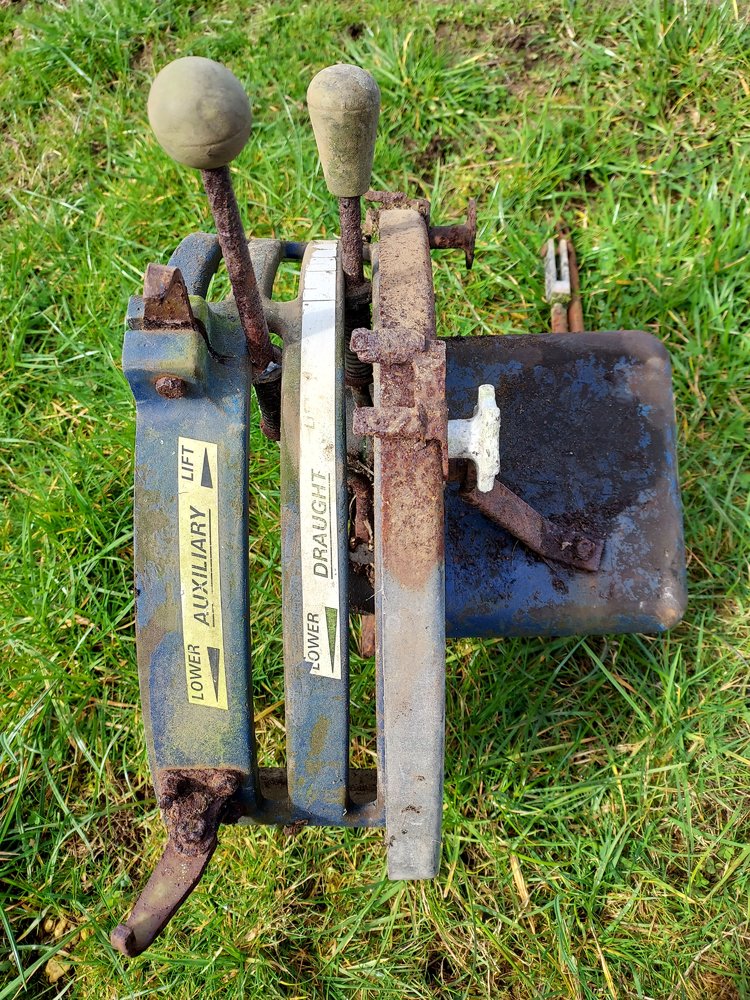

Fitted with front end loader, which is operated by two single-acting rams which appear to run from a tipper pipe. There’s a separate tipper pipe as well.
Two control levers, but the quadrant is missing so I’m not exactly sure what each does. Different from my Dexta.
Outer lever lifts and lowers the loader with inner lever in any position. You have to shut off the supply to loader with a valve to do anything else.
With loader supply shut off, rear tipper pipe works on the outer lever regardless of inner lever position.
With inner lever in the middle, rear link arms lift at all times. Won’t hold position, you can either lift or drop down, and that’s only controlled by inner lever.
A bit complicated, I know, but hopefully someone who know these can offer some pointers.
