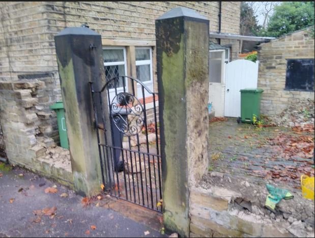

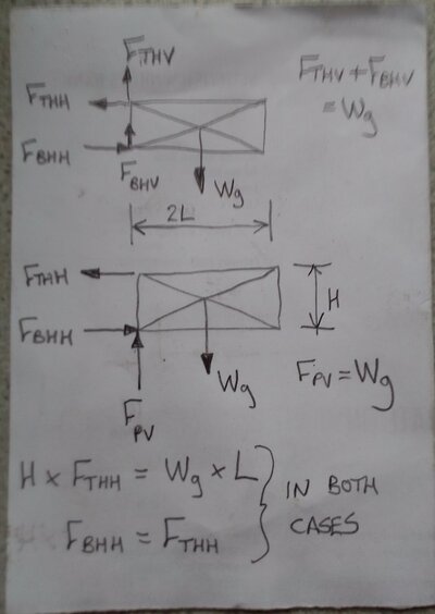

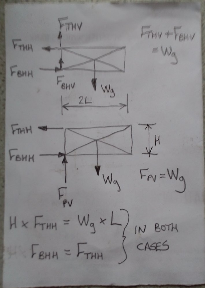

If you're hanging a heavy gate on a brick pillar and there is a danger of the gate pulling the pillar over, does it help if the bottom hinge sits in a ground socket instead of a bracket fixed to bottom of pillar?
I know most of the leverage is on the top hinges so would putting a bit of the load into the ground help?
