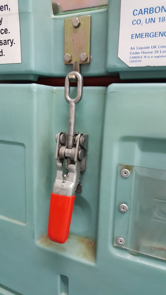

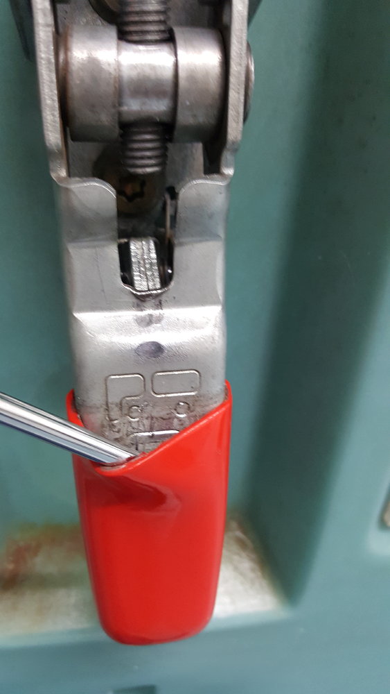

This one is worn out and needs replaced, does anyone recognise this logo?
Where has the wear occurred. Is there any chance of implementing some "wear compensation" by judicious bending of the existing catch? Might the existing operating lever have been bent back, preventing the catch from going back far enough to latch? Could something be welded or brazed on to effect a repair?

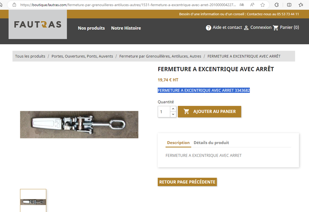

It’s called a loquet excentre

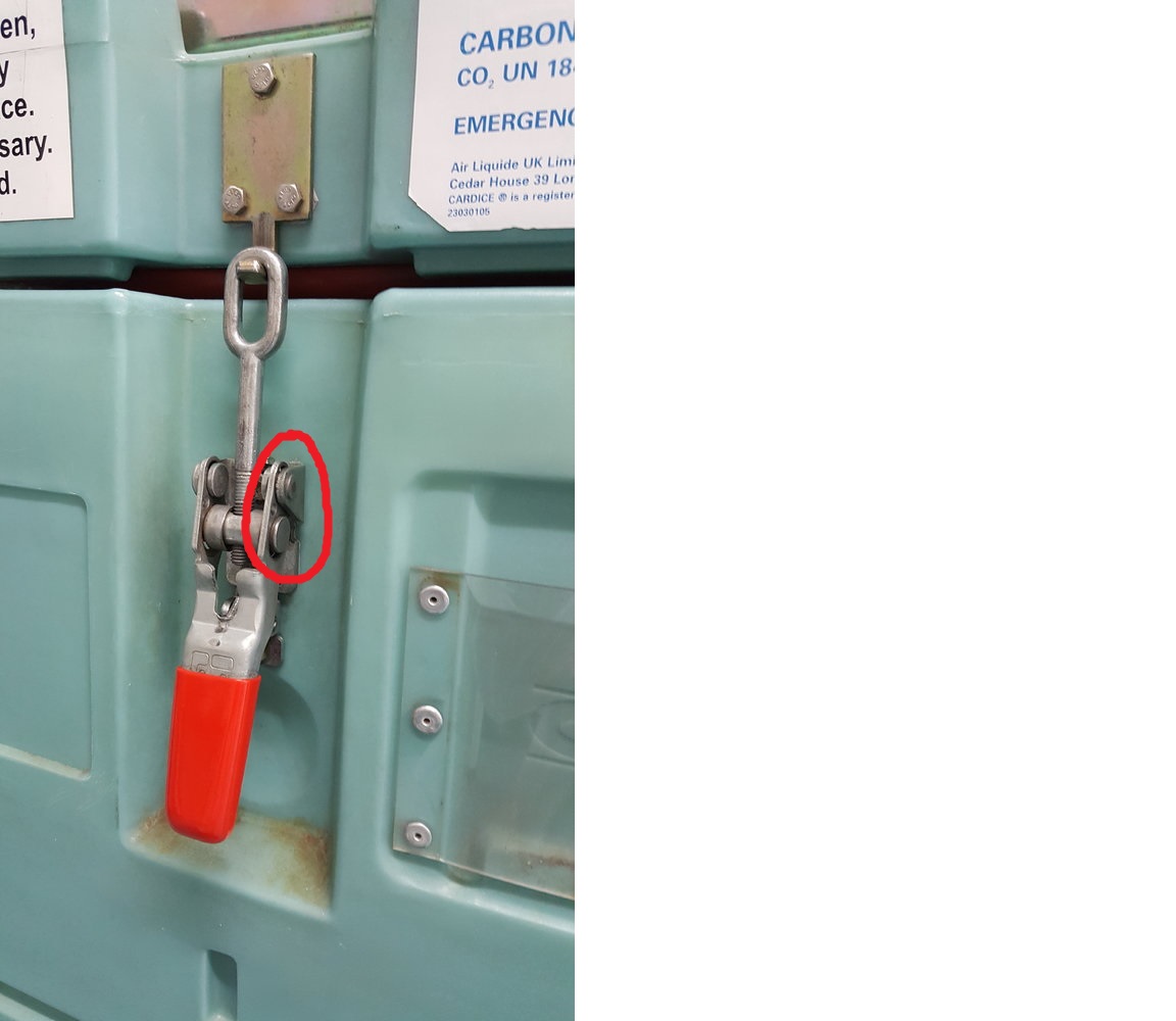

It's made in two sizes, short and long, I found these earlier on the apple web site.Not wishing to throw a spanner into the works or anything, but is there any possibility that style of latch is made in different sizes?
It would be annoying to spend the Euros or pounds only to find that the horsebox one is far away and the Air Liquide one is just small.
Hence, it might be worth still trying to find the OEM for the item.
