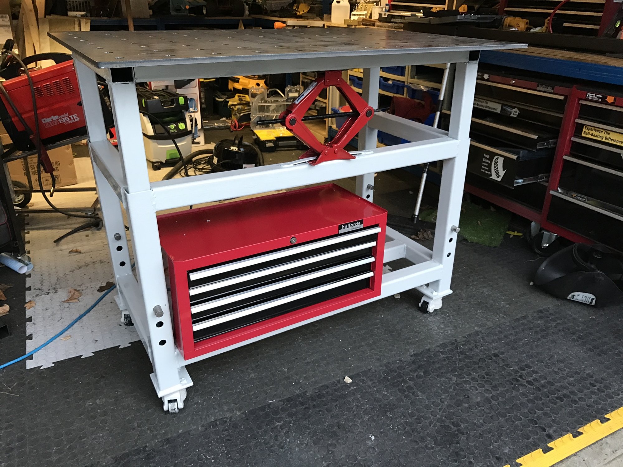

Now that I have a replacement grinder on order I'm wanting to resume working on my welding table. Before I start ordering components I think I require I just wanted to create a post to make sure my understanding is correct and in case there is a sim pler method to achieve what I want.
My welding table, even cut in half; is very very heavy, far too heavy for me to carry on my own, and I'd rather not drag it in case I damage the garage pad or need to move it outside, which would be very difficult to drag over. So I'd like to add castors to it so it can be mobile when it needs to be. As the garage where the table will be stored and most often used has a small slope to help drainage I would like to be able to adjust the castors so that they top of the table is level as nearest as possible.
