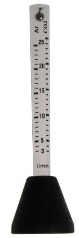

never even considered it, but if the valve to let the gas through is in the welder (it must be!!?) would air only get in the hose if the gas is turned off every session? or when changing bottles?
thanks hood...pdg....can you tell welding isn't my 1st trade!..there's a peashooter gauge like mentioned but it was set by trial and error (not touching it after it was set!) no real understanding of what should read whatSearch for tip flow meter. Peashooter isn't really the best thing to google.
