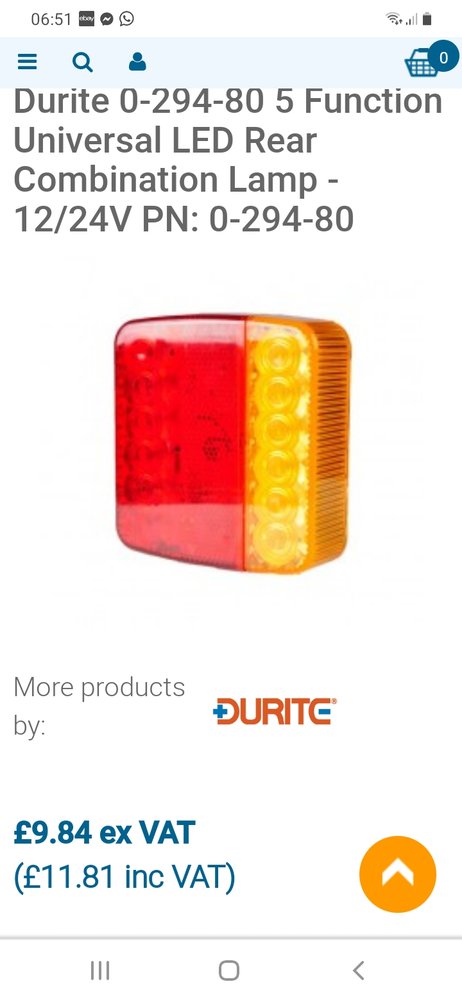

Any snags with replacing filament light on cheap Erde trailer with sealed led units ?
Won't be a problem with trailer lights. It's the vehicle that MAY need the resistor for the flasher unit to operate at the correct rate and possibly any bulb failure sensingSome of them need a resistor wired in to simulate the load of a filament bulb.
I had to try a couple to find some I thought were bright enough to be seen in daylight, especially at an angle.No more blown bulbs or rusty bulb holder's. What's not to like.
In theory, very little.What's not to like.
If "dynamic trailer lights" is the ones were the indicator "runs" along the light unit in the direction of the turn rather than just flashing like a good honest indicator,Oh and make sure they’re not ‘dynamic’ ones if your vehicle isn’t wired up for them.

Our main trailer customer has gone back to bulbs, as LEDs were more expensive over the long term.
The trailer LED units are just like the bulb units, built as cheaply as possibly, so they fail fairly quickly, and given they cost 2-3 times of an equivalent bulb unit, bulbs work out cheaper.

Strange they are finding that. I fit them to all sorts, 8 wheel tippers, quad trailers and all sorts and I’ve yet to have one come back. Even farmers, who abuse everything, seem to be unable to kill them
If your customer is running trailers just for trunking on air bags then that’s not saying much for something in the equation. Wether it’s road, drivers, lights or what![]()
Nah, little trailers.
It's the usual tale of the lights being aimed for the typical caravan/trailer that only get used a few weeks of the year, but when they get bounced around daily in all weather, they're just not up to the job.
The trailer manufacturer tried all sorts to make them reliable, but short of spending a lot more money on a more durable lamp, they just don't last. And if you did fit a more durable lamp, it just means they're more expensive to replace when they inevitably get broken.
So the most cost effective option is bulbs.
