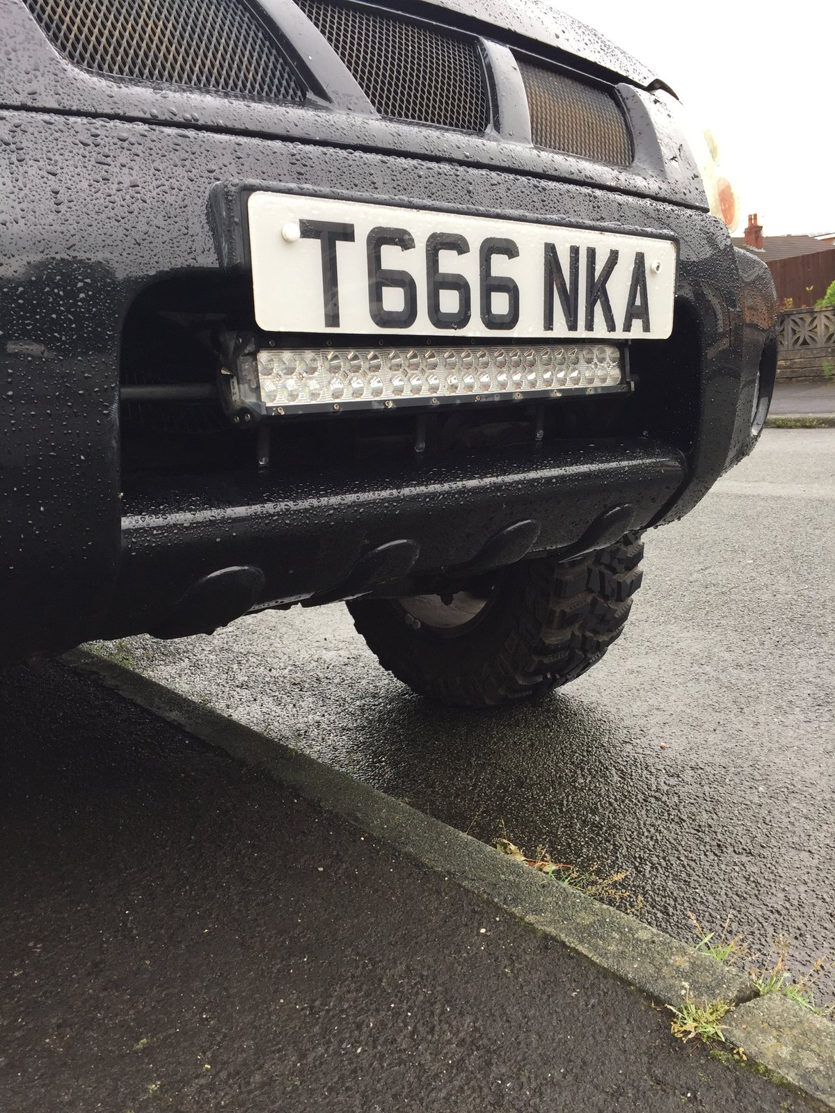

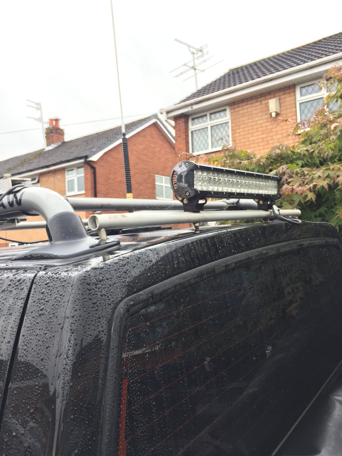

Ive 2 light bars on the pickup. the front is relayed through the main beam and a switch so it can be disabled. the rear is relayed through the reverse light switch, again on a switch so it can be disabled. they both get flicked off at MOT time. Ive also switched them so they can be switched on independently of the ignition for when working on the yard etc at night and need some extra light on the job
