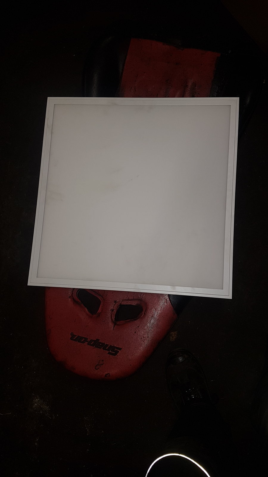

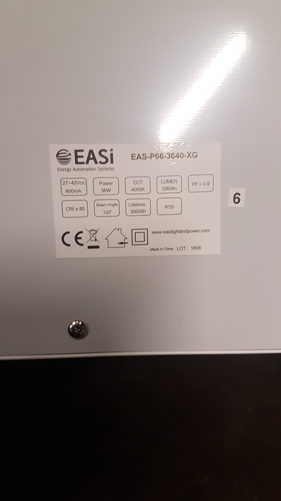

I was given some led light panels but only got one driver for them so need to get a few more.
These are the lights

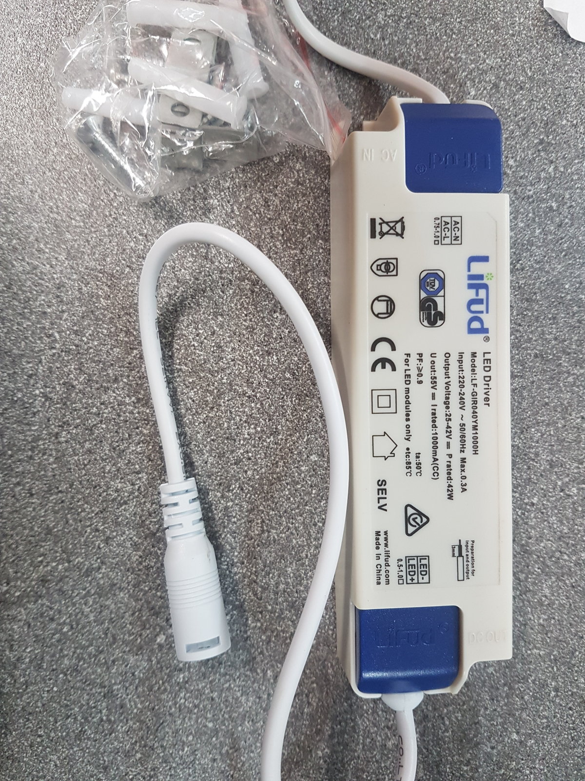

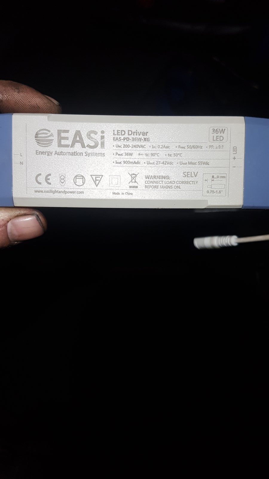

And this is the driver I got
I've looked on ebay and can't seem to find any that match this one. The 36w ones I've found don't match the voltage of this one, they're either 36w 12v or 36w 75-135v. I've contacted the shop they were bought from originally but they're not interested in selling the drivers on their own.
I was planning on using these in groups of 3 or 4, does anyone know if there's any way of using these with the higher voltage ones by linking them together or any other way to get them to work. The ones I've found with the right voltage are all a much lower wattage.
Any help appreciated.
