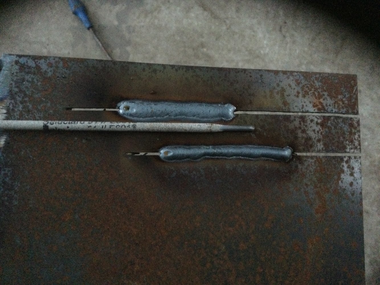

Tilt the gun toward the direction of travel (pushing). You got to be able to see the pool and the joint, otherwise just guessing. Closer to the weld (less stick out) gives hotter weld, further out gives colder, can be useful on thinner metal or filling a hole. If you make holes move faster or hold shroud further out.I'll give it a try lowering it next round. I was having a hard time see with the shorter wire length I had my head almost laying side ways on the table. I belive I had 1/2" length of stick out with the flux core I was using 3/4"
