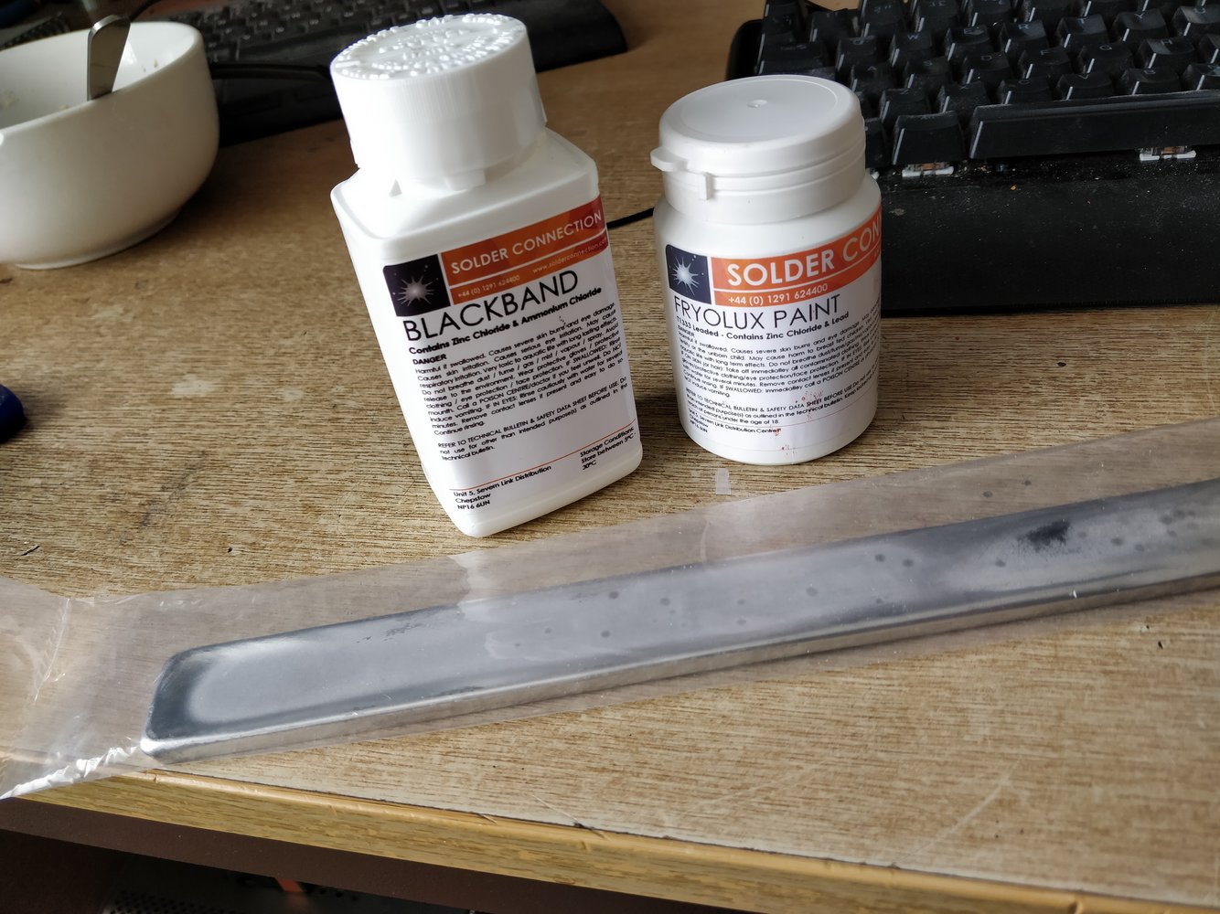

Was just going to use solder for some pin holes but now as I've bought the paste and solder I'm thinking, bah, lets have a go at doing the whole car.
Some questions and if you have any tips please share:

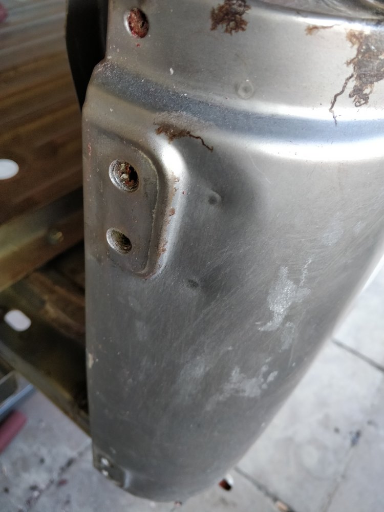

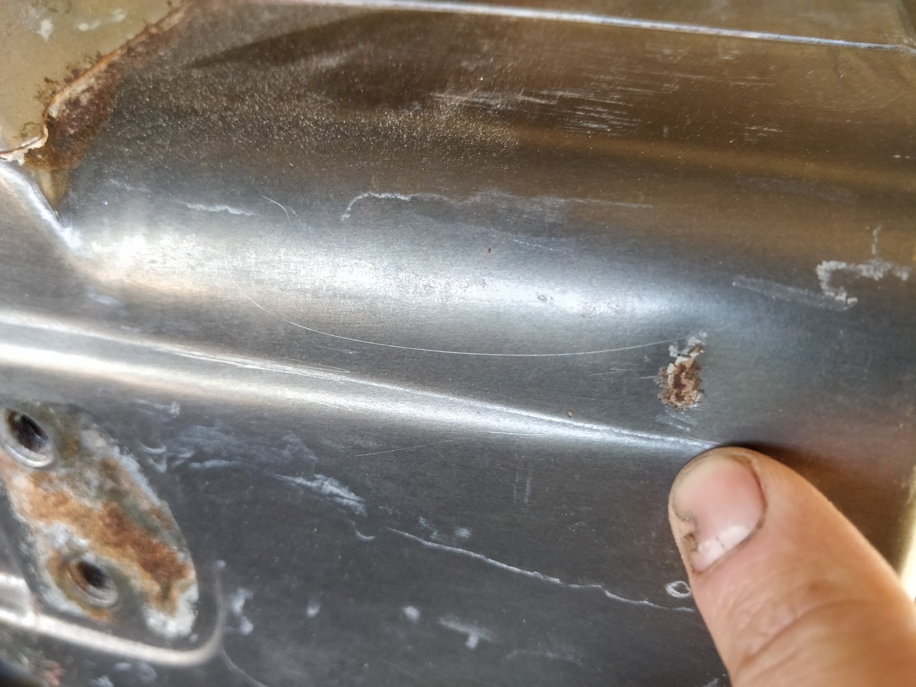

- I haven't got a paddle yet, is there any particular type or shape I need? It's to do a few dings around the car (one example in photo), the rust pitted sills and next to my tail door hinges.
- Someone on here said they recycle the solder. How do you catch it?

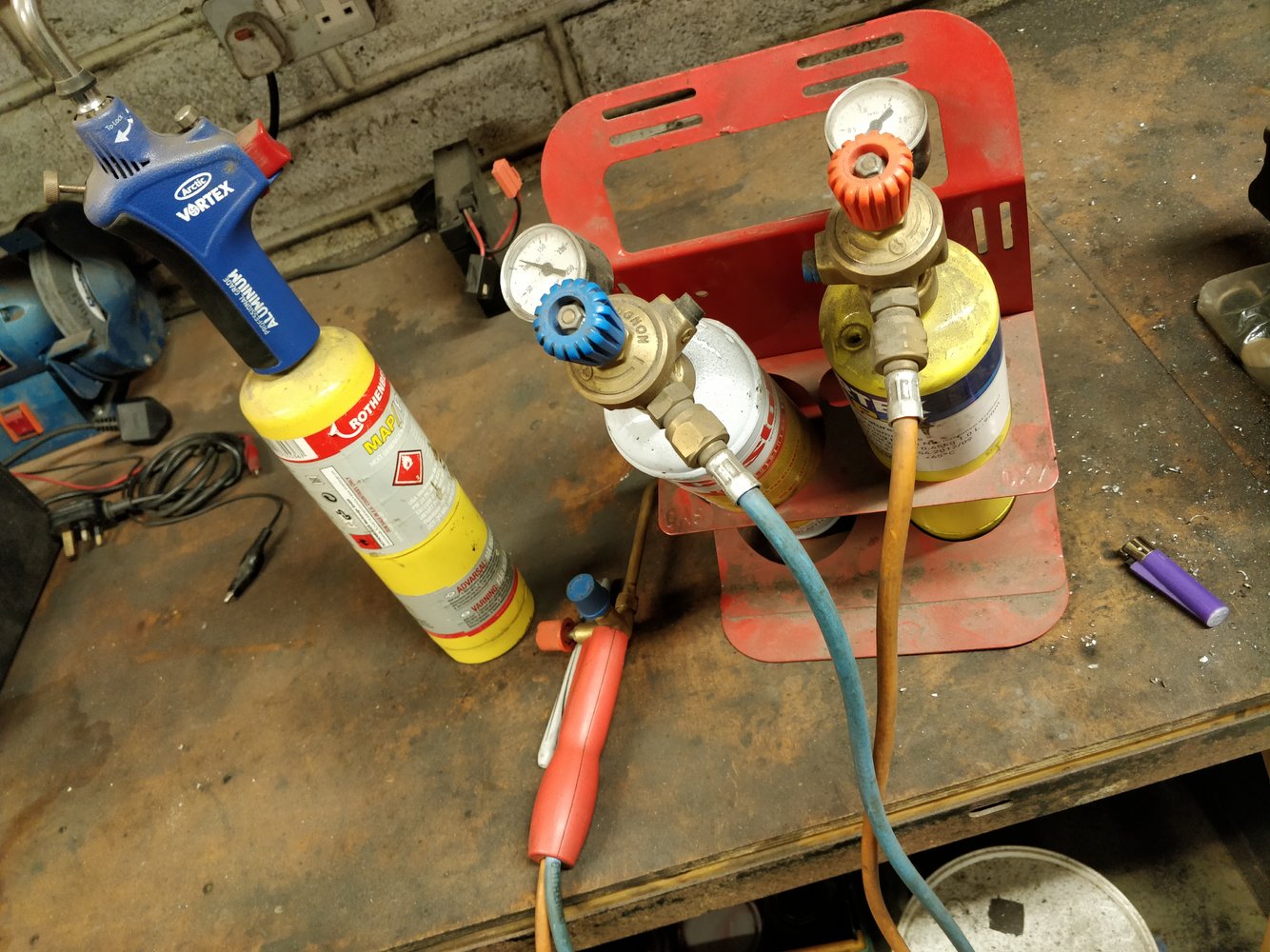

- Which torch should I use? I have a generic plumbers propane torch and a small oxy-MAP torch as shown, would either be suitable?

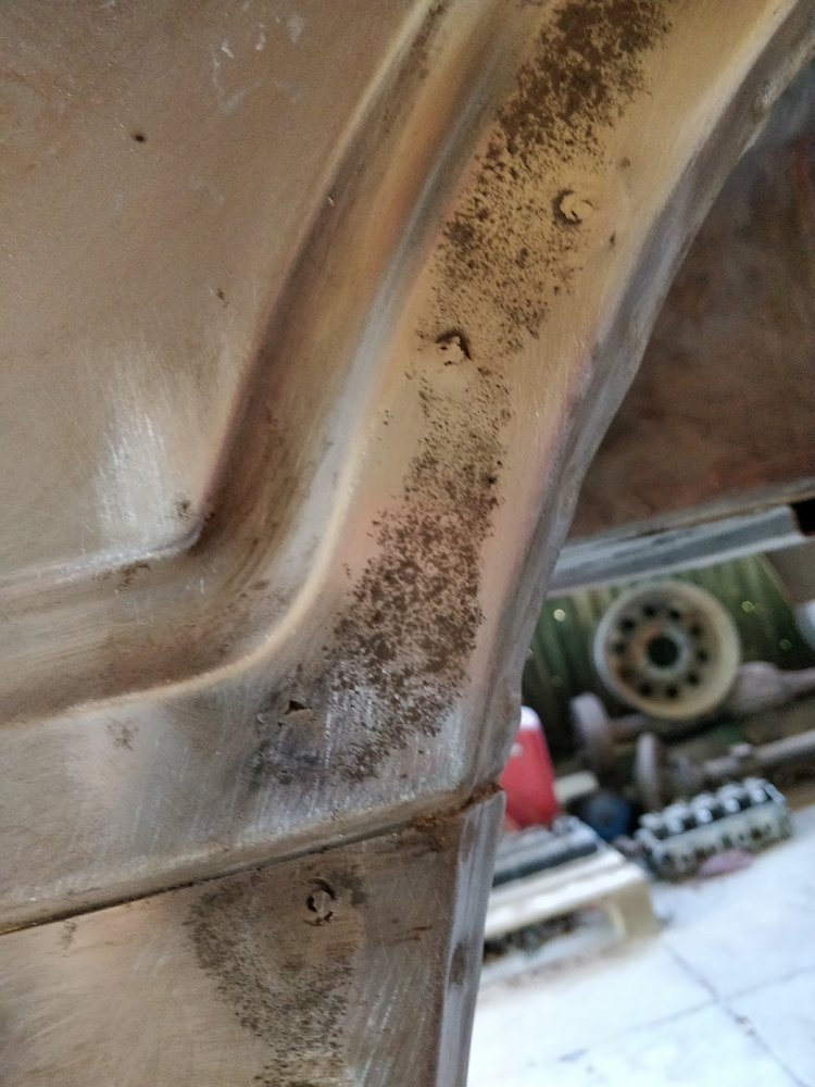

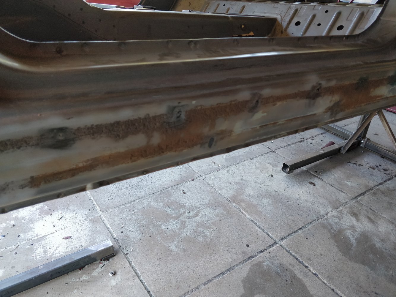

- The photo shows my sills + arch, when I removed the steel bracket that holds the plastic trim and extended mud guards I found a load of rust but it hasn't gone through, just deeply pitted. I'm guessing I need clean white metal to solder, so media blast first?
- And how to I get to a smooth paintable finish without using poly filler? Maybe several layers of epoxy primer and then sand back? Or is the lead just for deep dings and poly filler the rest?
- And talking of sanding, is a regular P3 dust mask enough, or is it filing only (no sanding of the solder)?
- How are you finding the imperfections in the metal to fill them, will that black powder (forget what it's called) work on bare metal? I'm used to priming, applying black powder then using a long block to find where to poly fill.
- One of the photos shows the hinge mounts for the rear door. The cable that stopped the door opening too far broke causing it to open too far and bent the re-enforcement inside the cavity. I've bent it all back as far as I can but it's left a recess. Is it safe to use lead this close to a stressed hinge where things might flex?
I appreciate that's a lot of questions, thank you in advance for helping!
