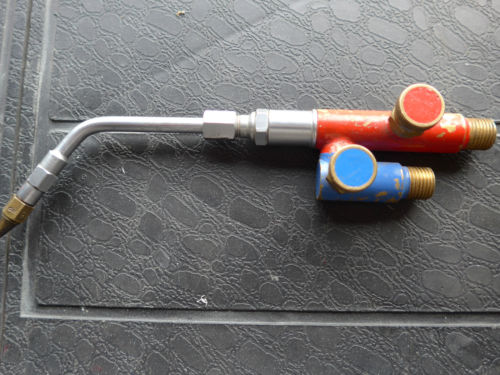

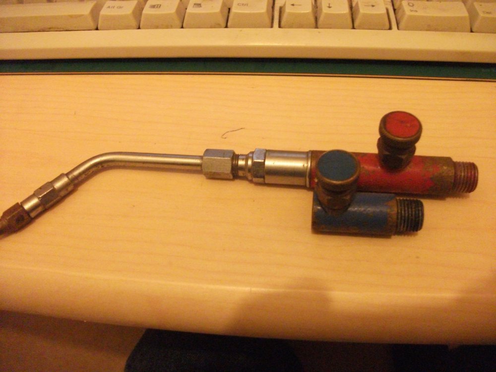

Should I just stick to a standard torch on Ali?
Hi and welcome,
Stick with a standard torch unless your parts are very small the heatsink effect will be noticeable.
There was a new member who joined earlier this year that was also gas welding aluminum. I he was looking for blue shade goggles from memory, might be worth a search for you.
Good luck i used to enjoy gas welding ali although i haven't done any for years, keep a close eye on the pool as the difference between it getting a little too big and hitting the floor are very narrow.
