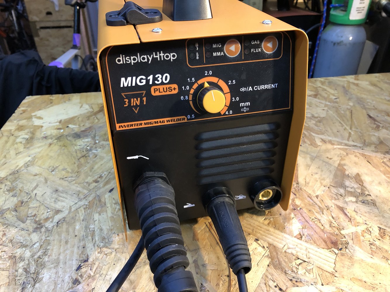

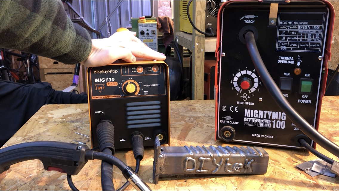

So Brought this Welder from Amazon For a friend and hes let me do a review on it links Here

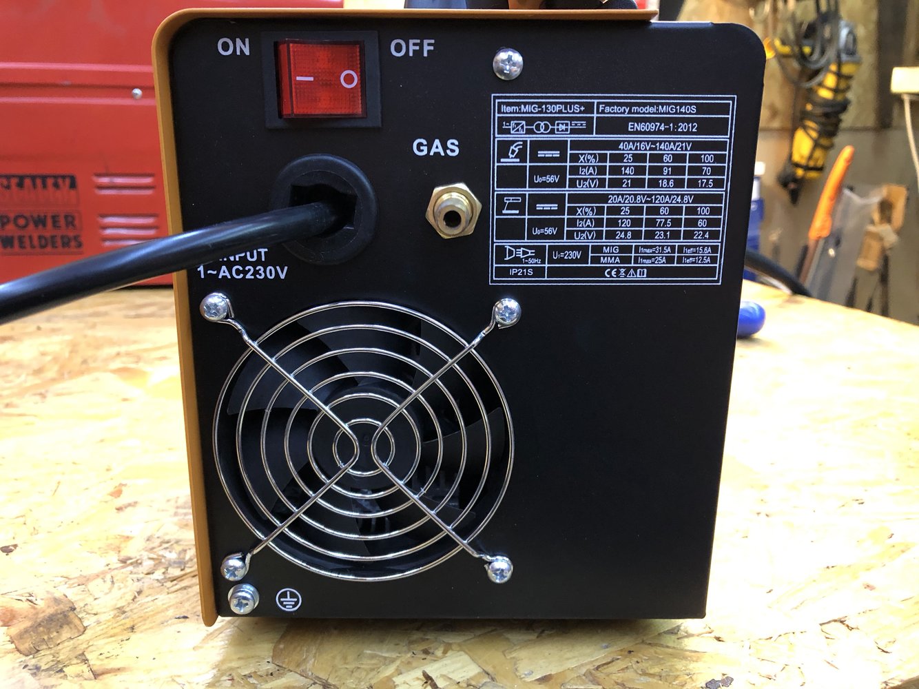

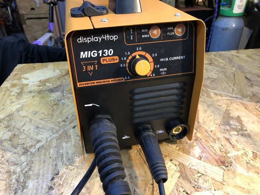

user manual states "MIG 40-140A / MMA 20-120A but it feels like 20a on the mig low setting but i can't test this my clamp meters not working.

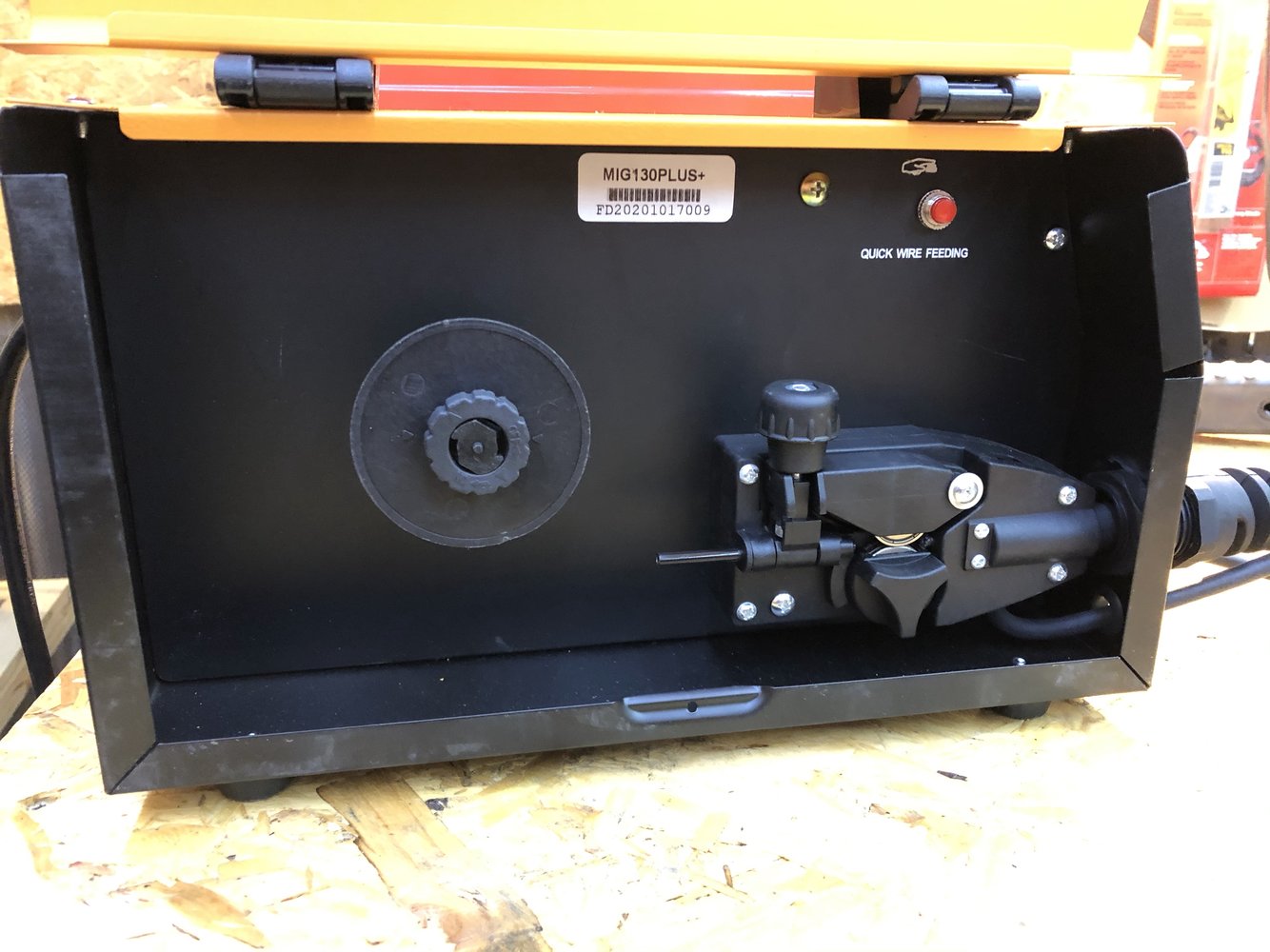

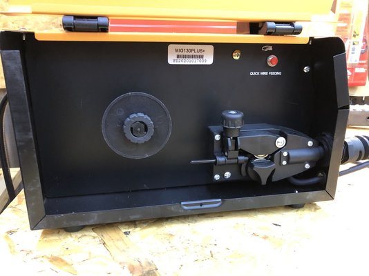

it has two push buttons one you can select mig or mma other mig or flux core. has one power setting knob the wire speed is preset to the amperage
so you just select the thickness of material your welding on. was sceptical this would work but it seems pretty much bang on .

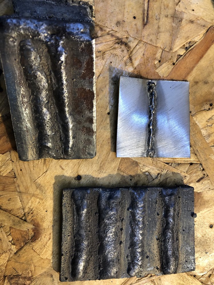

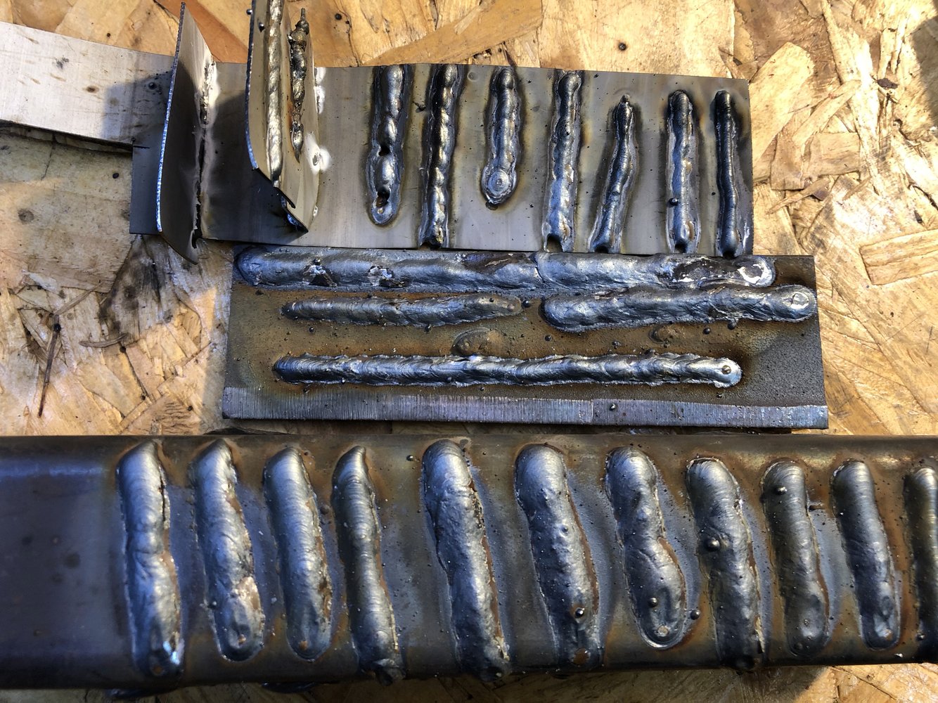

nice smooth weld with hardly any spatter with flux core wire, mma welds nice and smooth with 3.2mm 6013 not quite as nice with 7014 rods but still runs good.
done some mig welding with 100% co2 not bad welds came out nice
mig welds not a pro welder
flux core on the 1mm sheet
I made a review on youtube

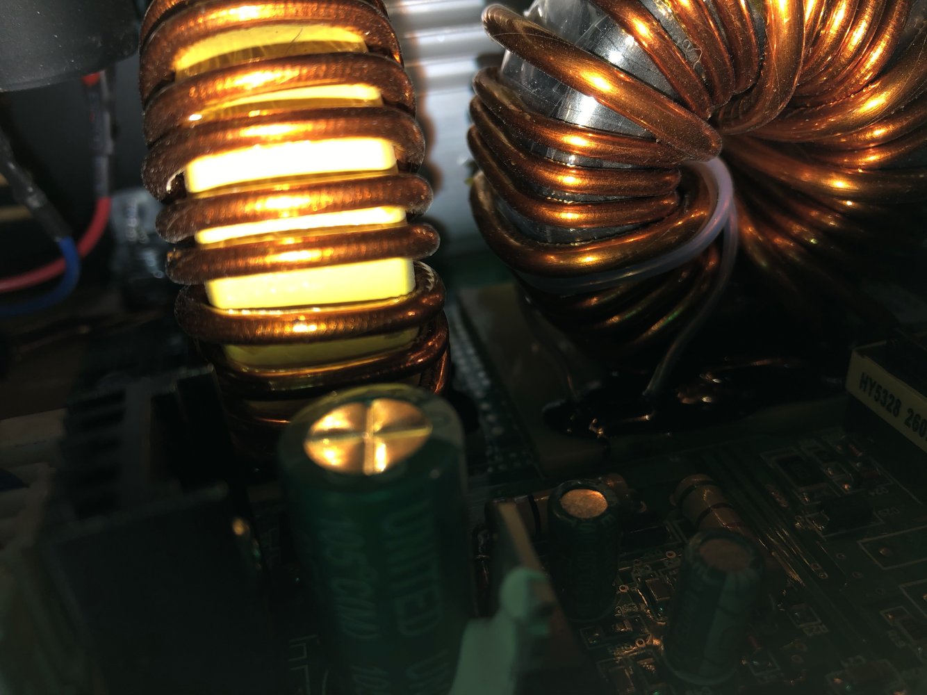

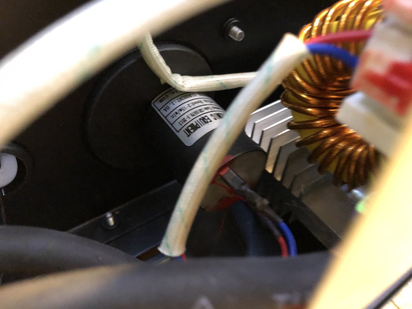

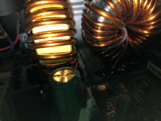

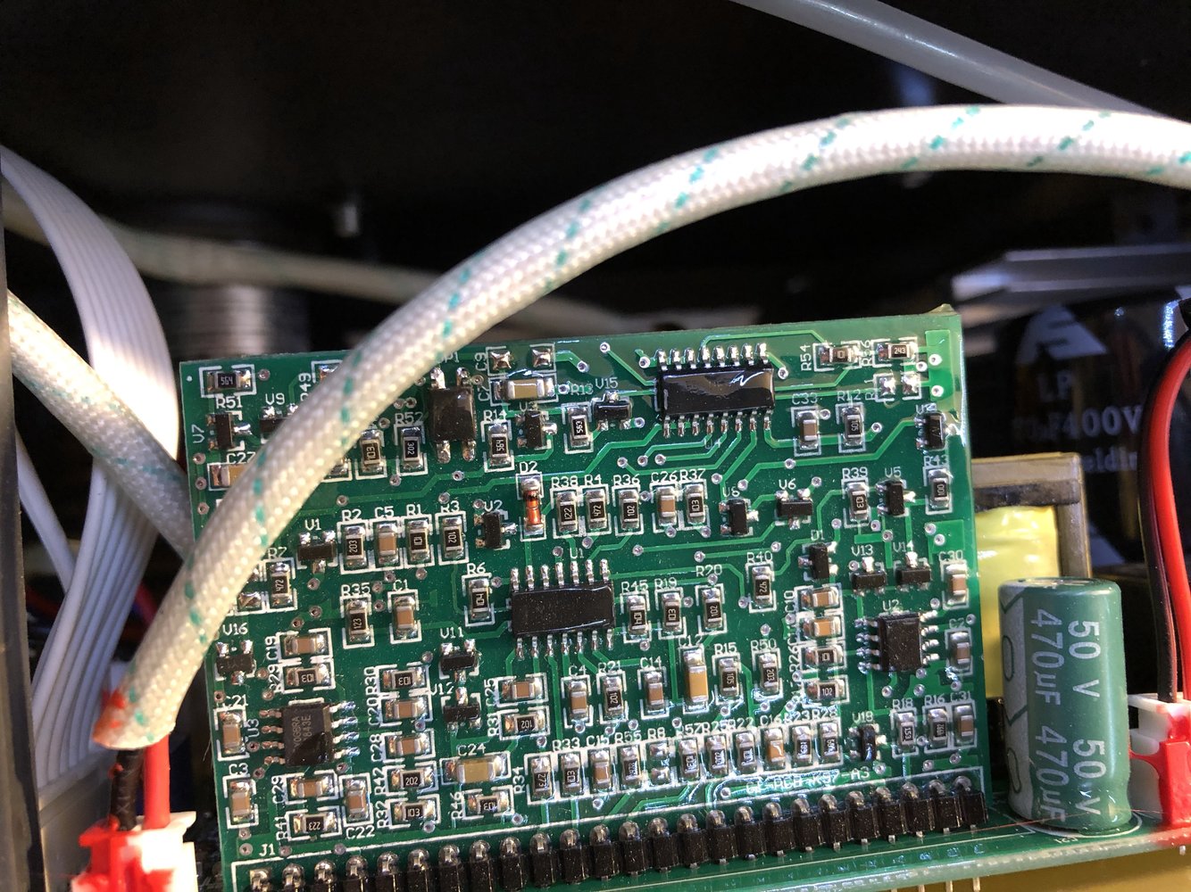

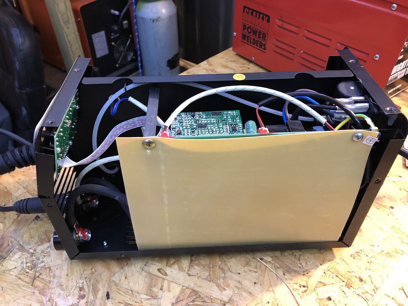

some pics of inside of the machine
