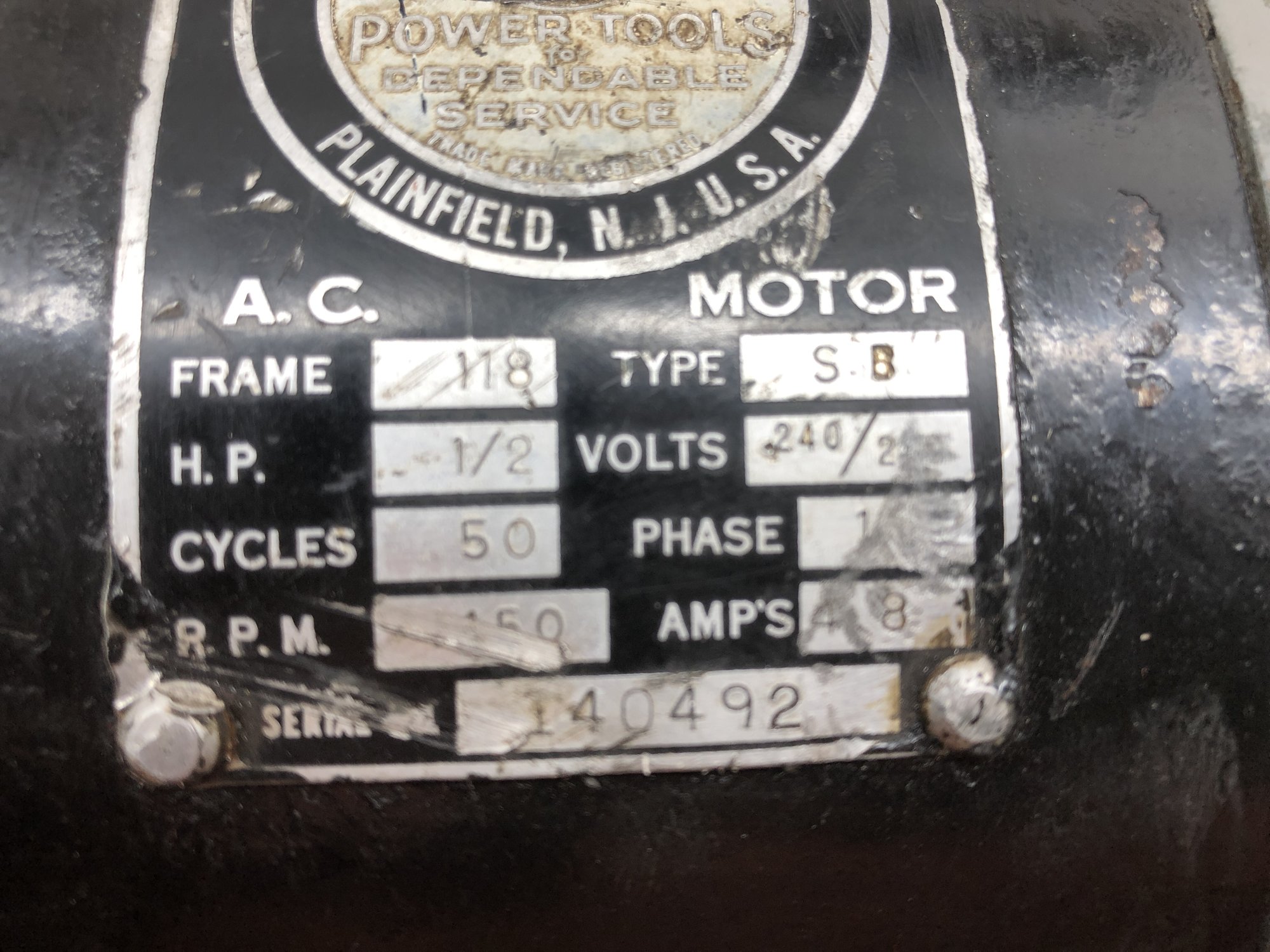

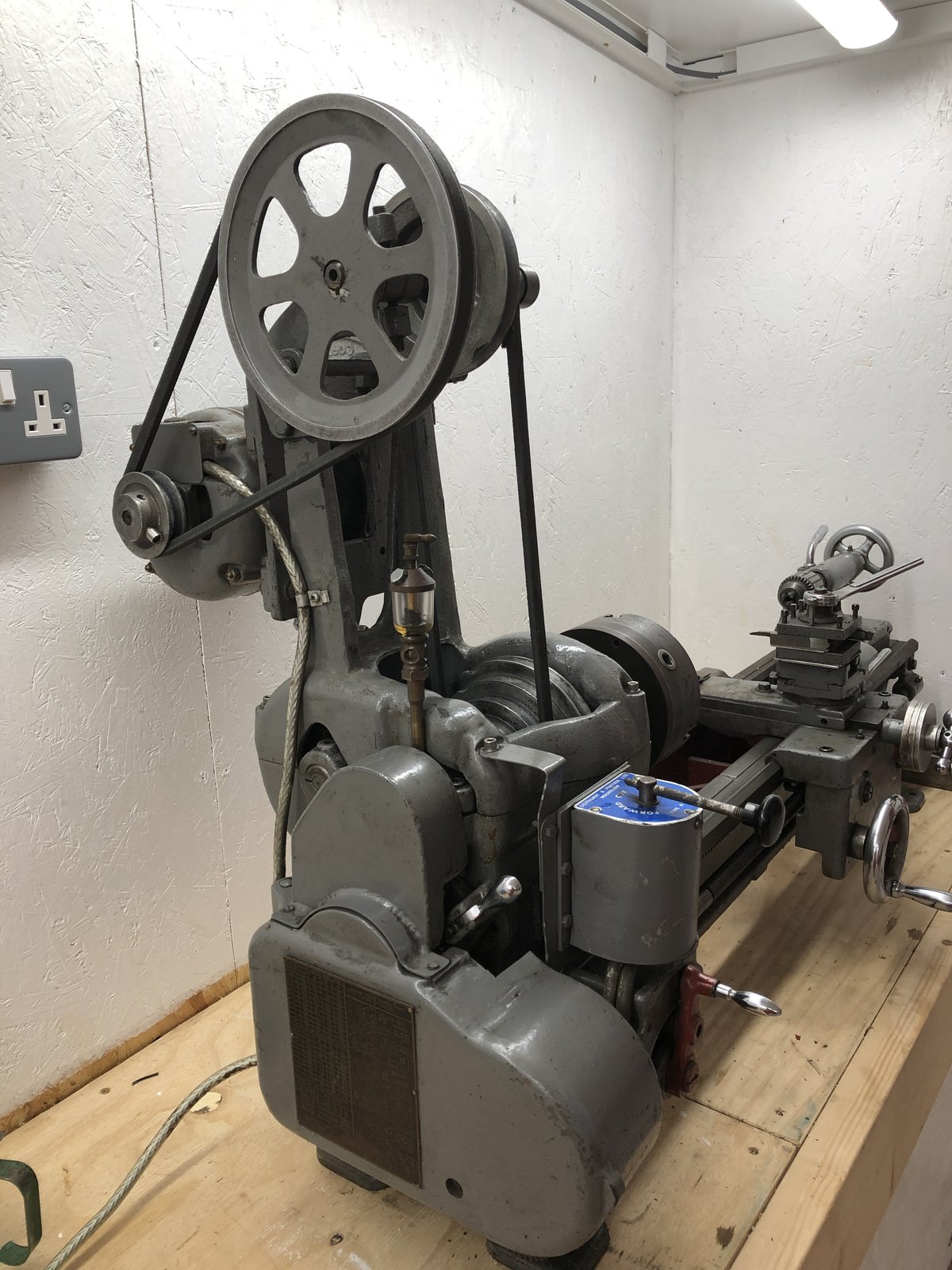

I pulled the motor and loads of other parts off of my ancient pre war lathe, when I moved houses six months ago, and today I got it moved into the new shed and started to assemble it.
However, dickwad here didn’t appear to take notes of which wires went where on the motor.

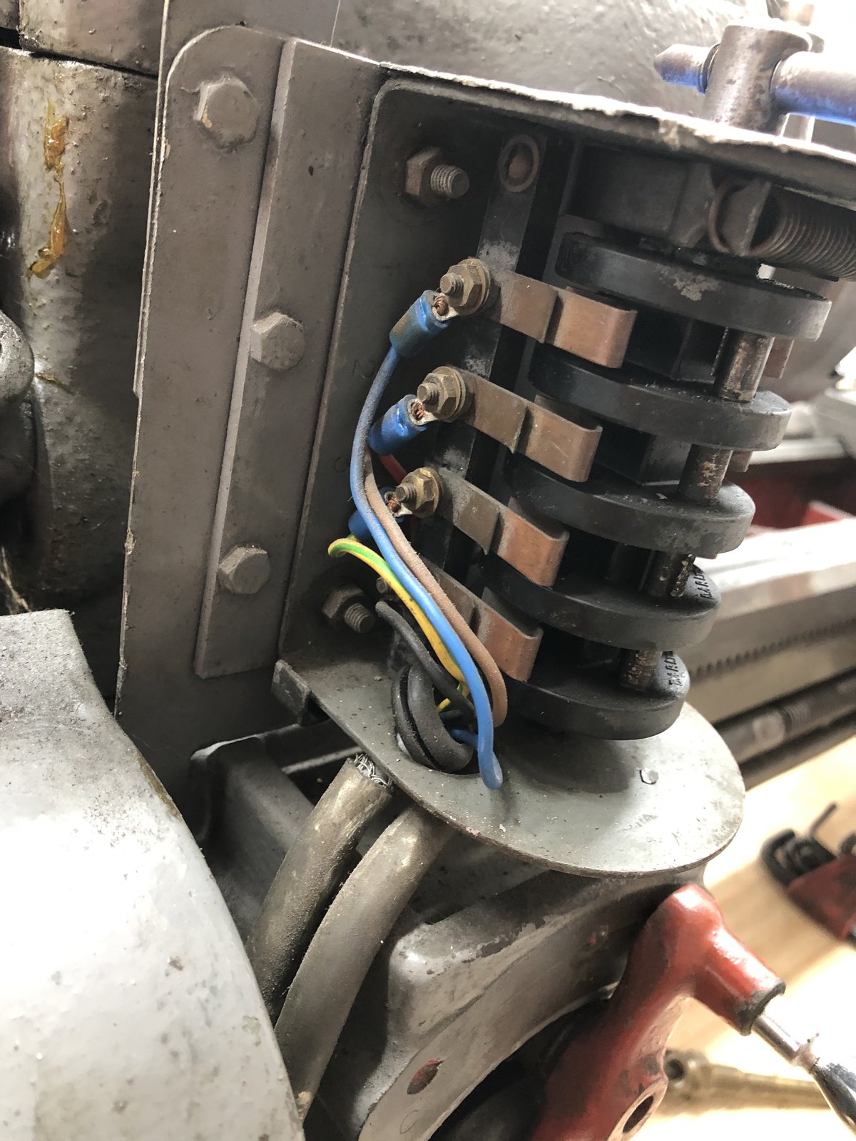

There is an old mechanical type switch, and four wires go from that to the motor.
But I have no idea what connects to what.
Help.

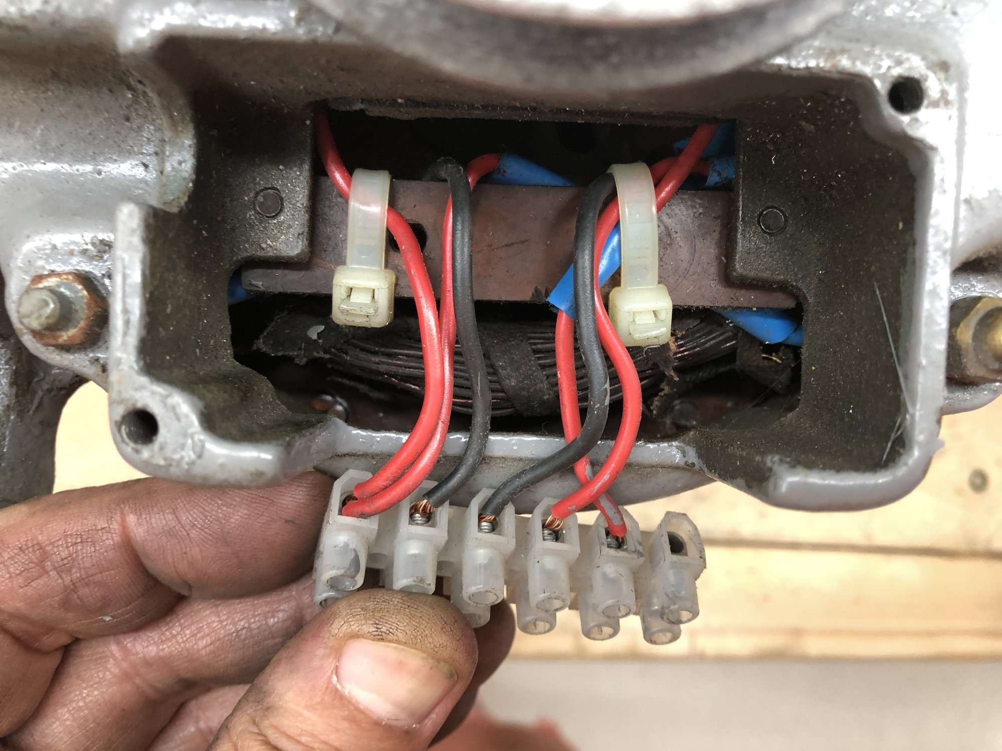

Two reds, two blacks on the motor. The two reds at the end appear to just be joined together.

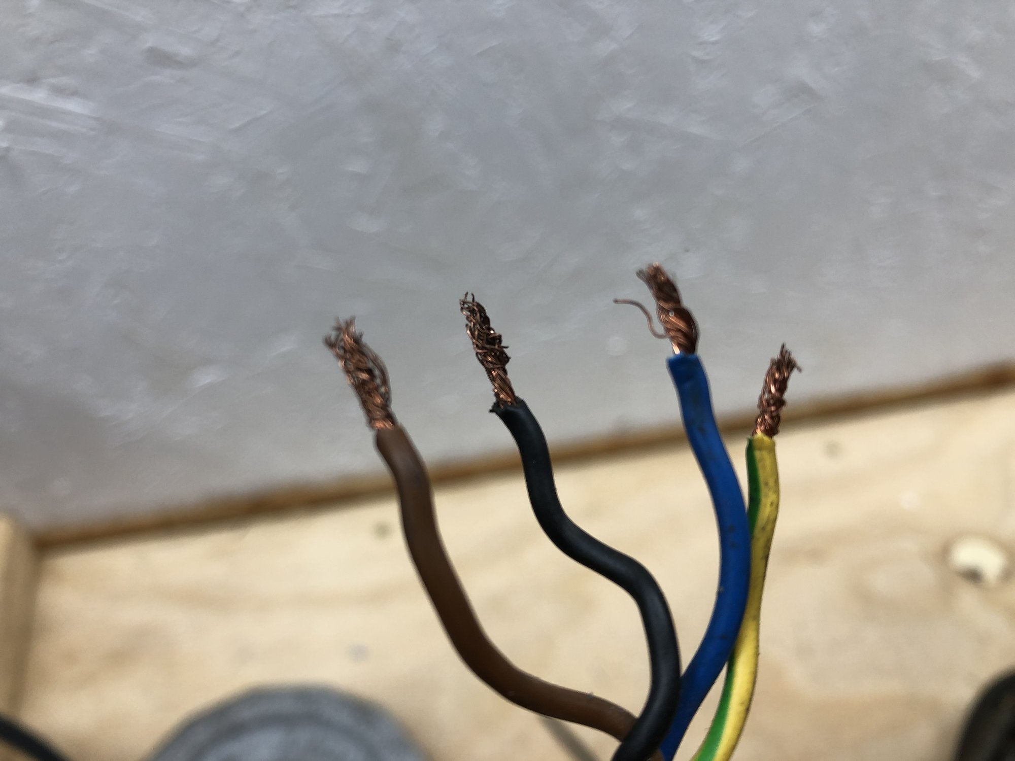

The wire to the motor.
The control switch.
The control switch.
You will get a resistance reading from both pairs. but the start winding will be in series with the centrifugal switch.
