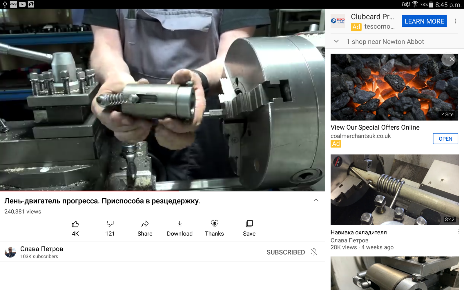

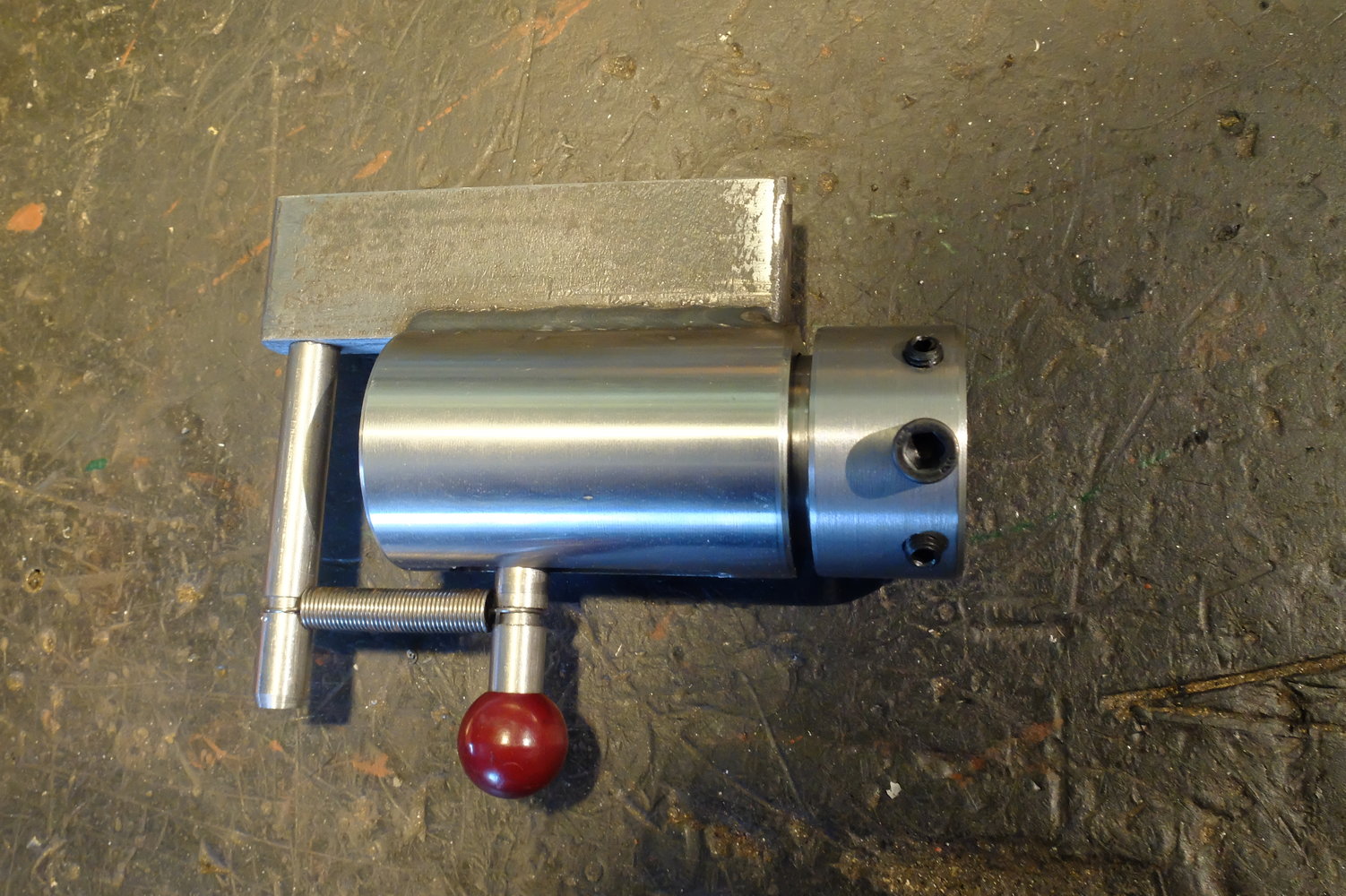

Hello all, pinched the idea for this dieholder off a Russian machinist on Utube. Cant remember having ever seen  one of these before, tailstock yes but not on the toolpost. Simple idea, spring loaded with a lump of 10mm flat welded to the tube. The red knob is just because I had one lying around !. Nice little project....
