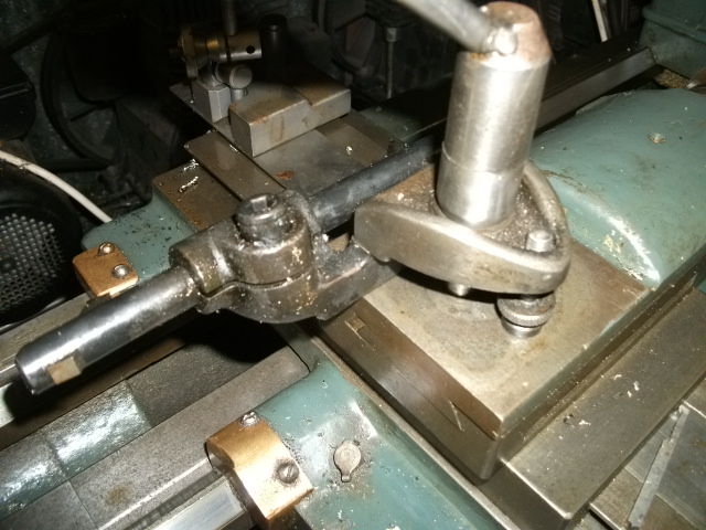

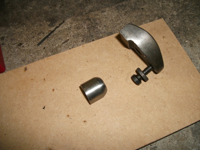

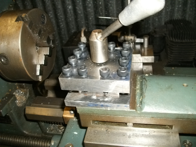

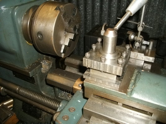

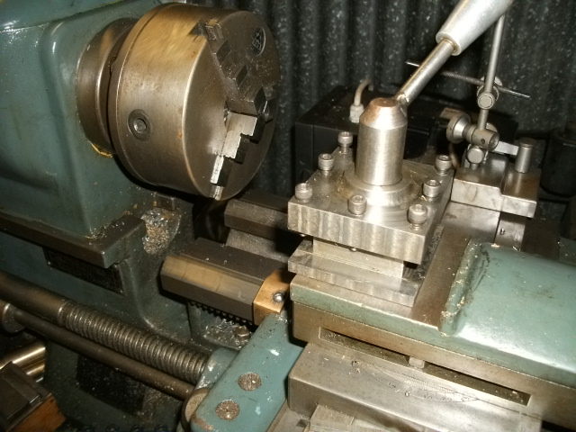

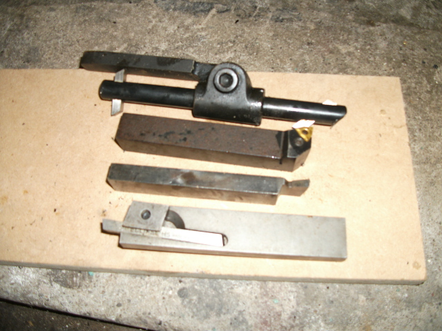

the 4 tool post on the harrison L5 lathe will only take 1/2inch tools due to the topslide height . i bought a myford tool holder for 3 quid that bolts direct on to the top slide giving extra height . now i can use the larger cheap tools that are available at rock bottom prices at car boot sales
i also made a spare toolpost it saves swapping the various tools and setting them up each time
