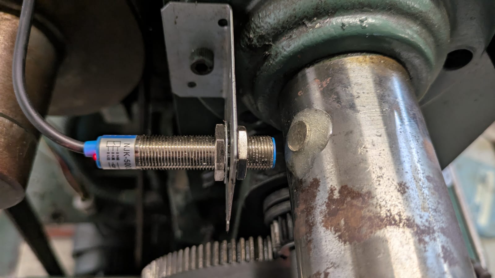

I have installed a tachometer onto my lathe.
it is listed as 8-24v power so i ran it off the 10v from my VFD. It worked but speed was all over the place, be 1200 then 600 etc never stead.

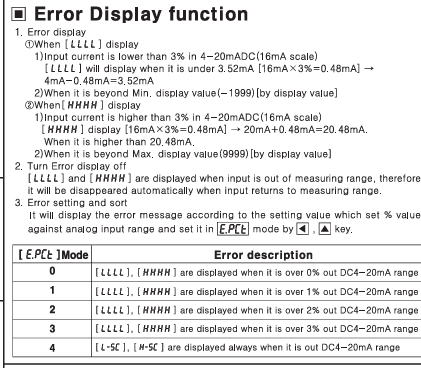

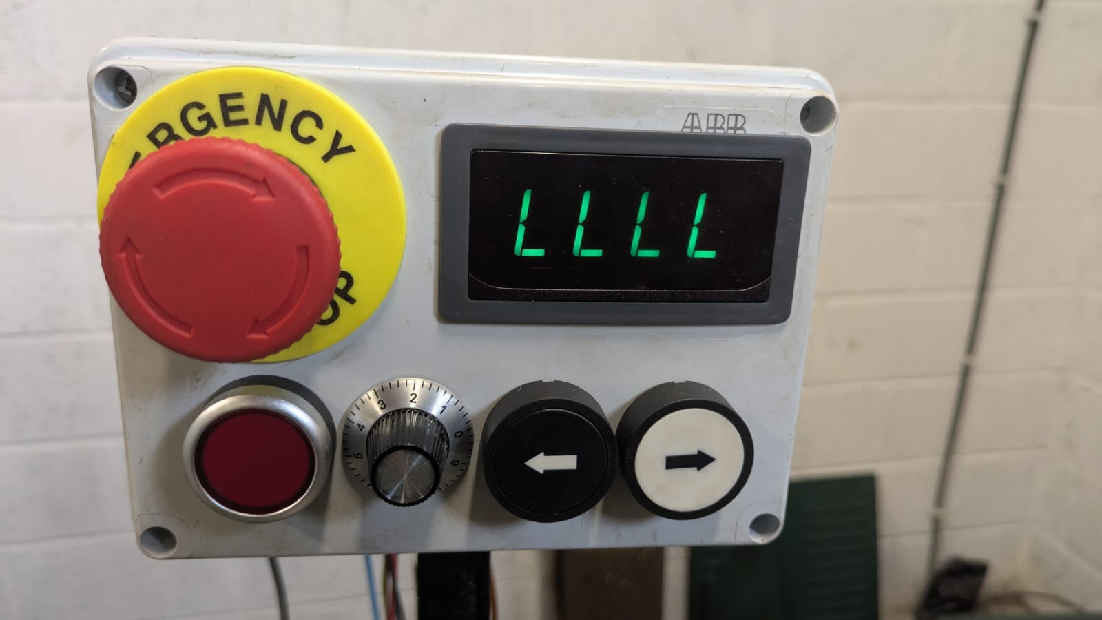

So i tried rule out the VFD and powered it direct off a 9v battery and all i got was LLLL
Then decided run it off the 20v supply from VFD thinking 9v was to low, but still all i get is LLLL.
anyone had issue similar, weired did work but stopped when changed power supply, tach unit is getting power as LED is lit.
