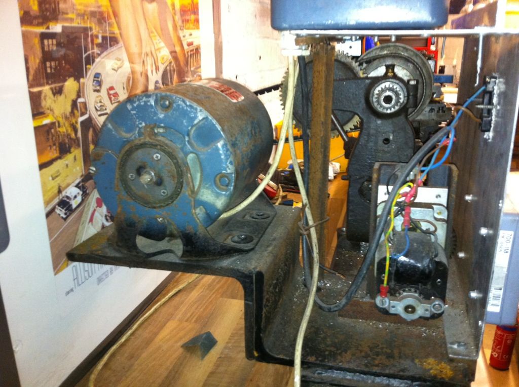

Had the lathe running on the bench today, it has a one of these on/off switches with the big red stop knerb....Sorry dont know its correct name.
It ran fine when I bought it, now the power to turn the chuck over is intermittent, motor gets warm/hot to the touch. IE it runs , glitches, slow runs,glitches, hics , runs a bit etc. Sometimes doesnt fire up at all. When I whipped the switch cover off and worked the switch manually it generally worked.
I ran the motor off the lathe with a plug on, and it threw my garage trip. However it ran smoothly and quietly prior to clicking the trip. So rather than go for a dodgy on/off switch I have stripped and cleaned the motor. Brushless type, and all appeared well other than being grubby.

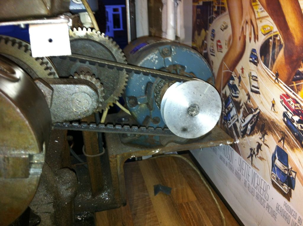

Ive just noticed the lathe headstock bearings were dry (now oiled) , could it be a "tight" lathe causing the hot motor and the trip dropping out ? It was reasonably tight to turn over by hand...?
