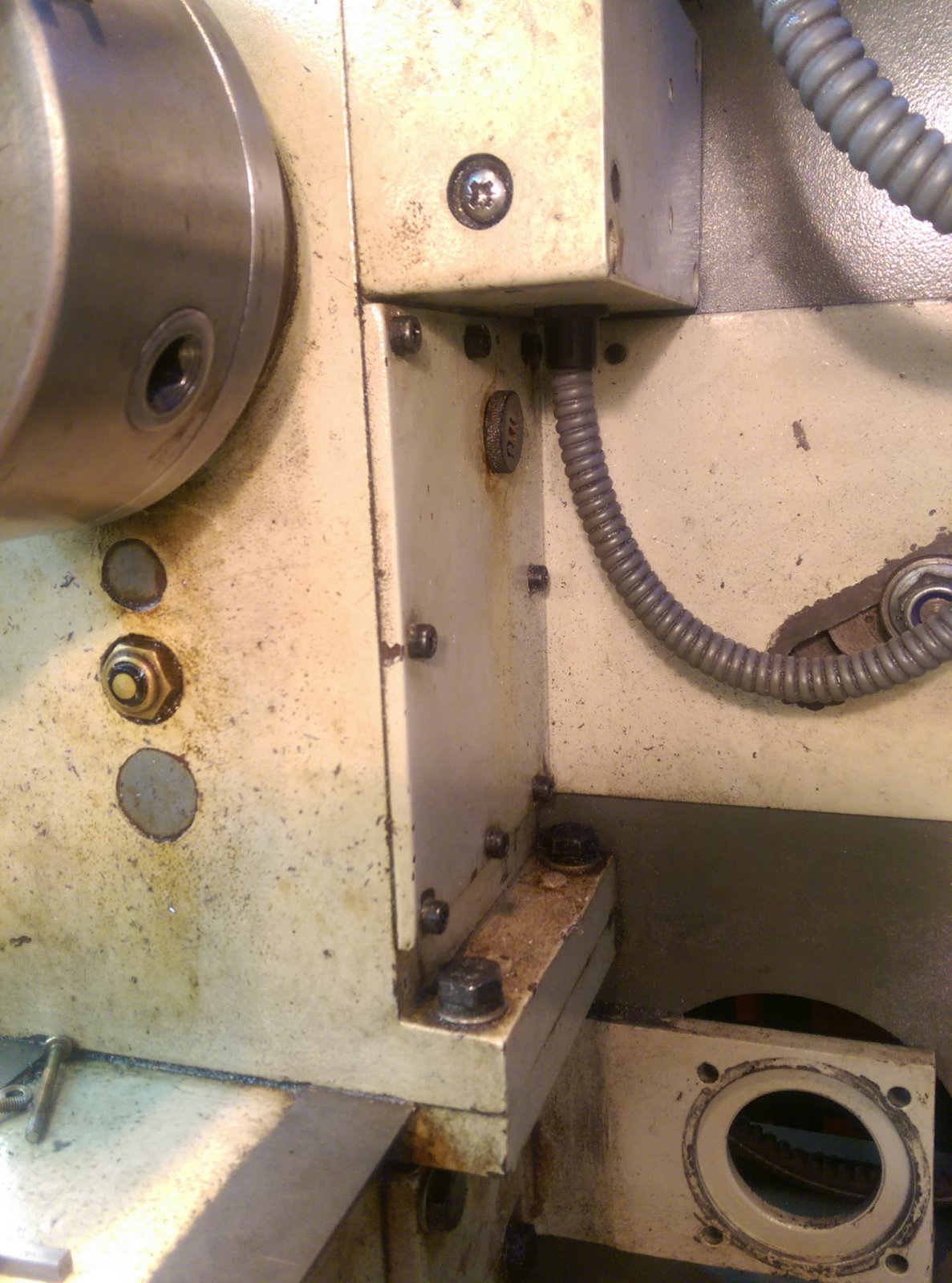

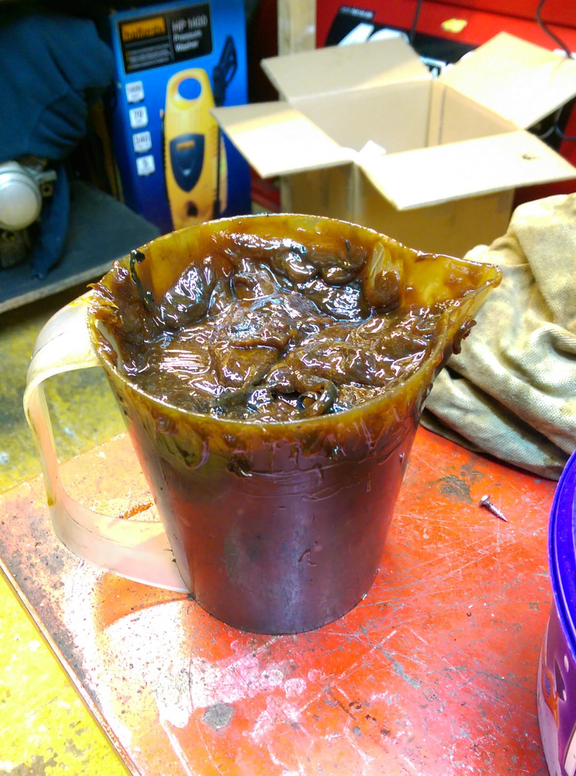

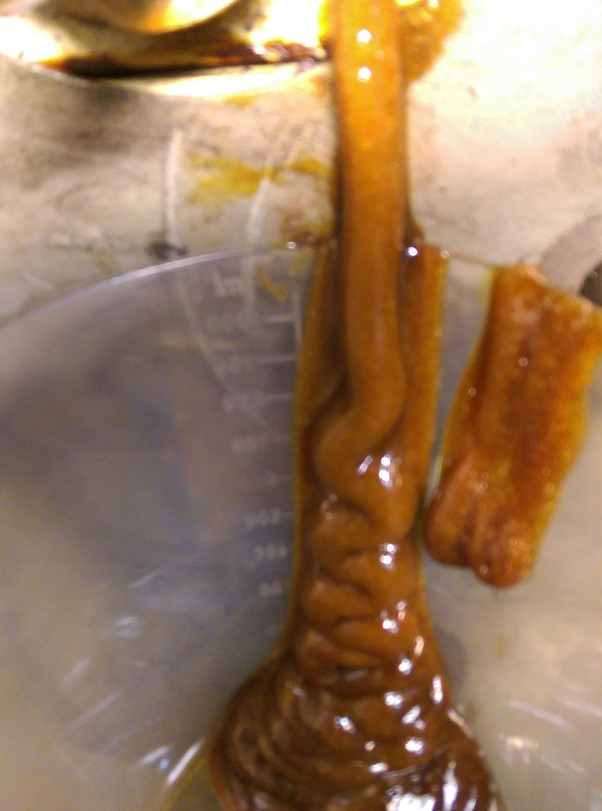

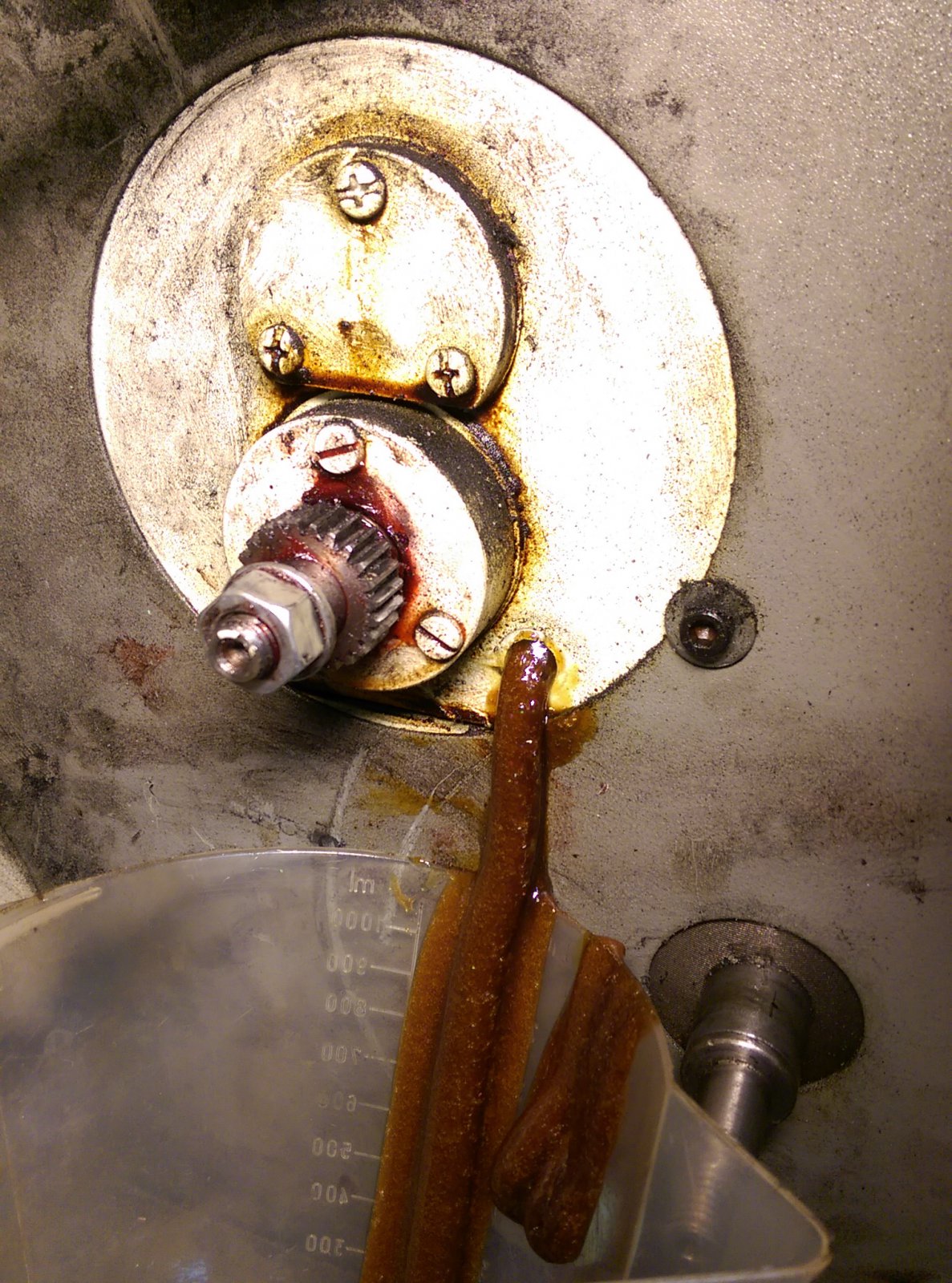

Typically the headstock gear for this class of lathe will be splash-fed from the layshaft gear. There isn't normally a huge amount of oil in the headstock, certainly not up to the spindle.
All depends what method is used for lubricating the spindle bearings. On both of my Denfords the spindle bearings run in grease and the gears are splash-fed. On the Bantam I had there was a channel cast into the headstock casting and the layshaft gear would fling oil up onto and then it would run via the channel down a hole into the bearing. The better machines have oil pumps.
Look around the front spindle bearing. If there's a grease nipple my guess is that your bearings should be (sparsely) greased and the headstock have about 2-3 inches of oil in it.
