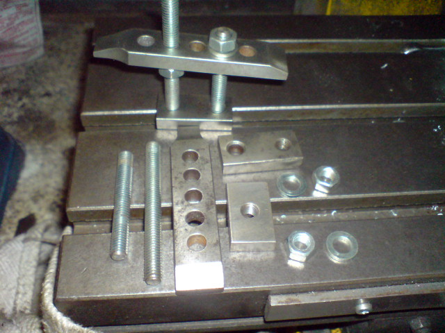

Interested to know what anyone else uses to clamp work up for milling. I cut up and drilled a few scraps of 5mm mild steel.. not much good - they all bent! So need to make some more, and some parallels.
Decided to drill and tap some holes in the vertical slide, using the lower T slot wastes a bit of travel.. So now I can clamp a bit lower. I got a lump of tool steel off ebay, so I made vice jaw to bolt on. Took an hour to hacksaw through it and carbide cutter to get it flat.
I guess a fly cutter would give a better finish, so that might be next job.
