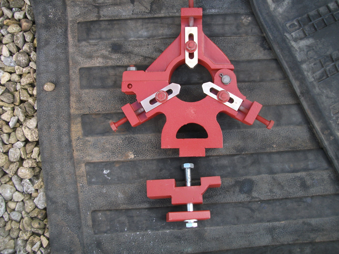

M Mr happy Member Messages 39 Location Yorkshire Oct 29, 2021 #1 Hello can someone who has a Harrison lathe please tell me if a L5 Harrison fix steady will fit on my Harrison 140 metric lathe Thanks mr happy
Tinbasherdan Bodger in chief Messages 7,553 Location Bolton, England Oct 29, 2021 #2 I might be wrong but if it’s a 5.5” centre height l5 then I think so, yes.
The Artilleryman Member Messages 446 Location Boston UK Oct 31, 2021 #3 L5 is 4.5" L5A is 5.5" 140 is 5.5" According to my Operator's manual, so NO. L5 & L5A are not interchangable as several on here have fond out.

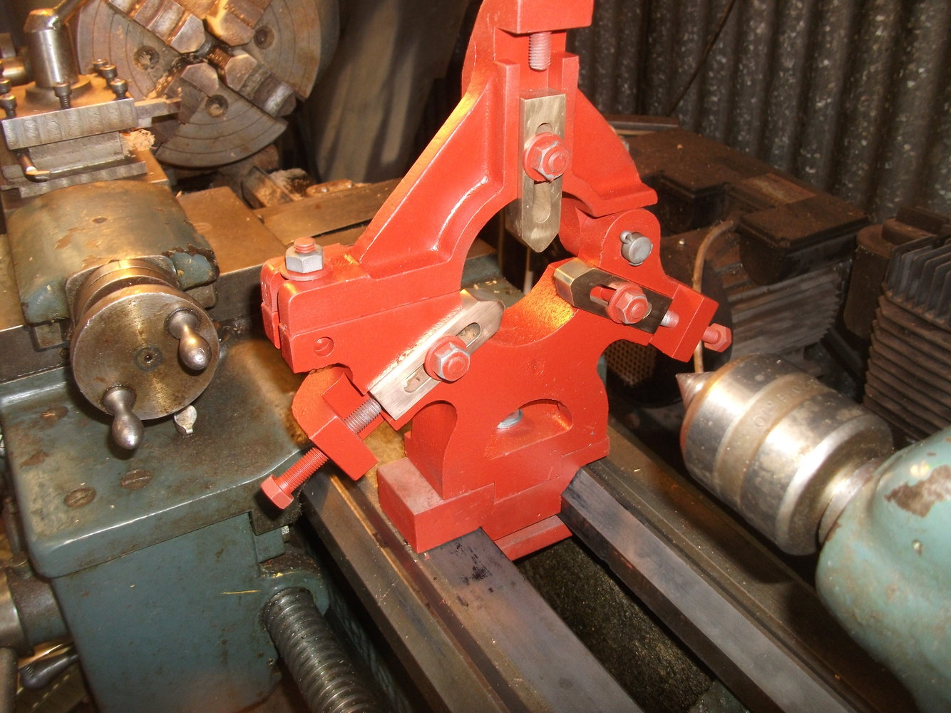

brightspark Member Messages 41,357 Location yarm stockton on tees Oct 31, 2021 #4 Mr happy said: Hello can someone who has a Harrison lathe please tell me if a L5 Harrison fix steady will fit on my Harrison 140 metric lathe Thanks mr happy Click to expand... it will if u can get one big enough for purpose and cheap and make a base to fit the bed and raise the height
