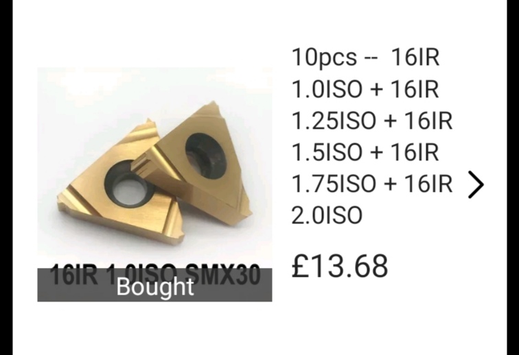

If they are Internal Right Hand Inserts, the IR suggests they are, then you can not use them for right hand external threads as they will not fit in the holder. Well they will fit but the cutting edge will be facing the wrong way.
A picture of the actual inserts will be the way to know for sure what you have.
