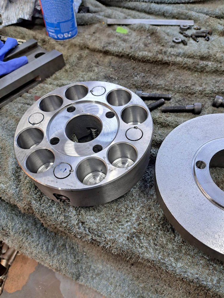

I recently got a harrison 140 and wanted to put a new chuck on it that I won at an auction. I got a new backplate and mounted it on the lathe, machined to size and left a small tenon of 4mm to align the chuck. The tenon was a very snug fit. The chuck is a new Tos svitavy 4jaw self centering. They look quite good quality. After I installed the chuck and put a clock on it I got 7thou runout.
I would of thought it would be better considering the close fit?
Should I do the tenon a bit smaller and then just dial in the chuck to run true before fully tighten the bolts.
