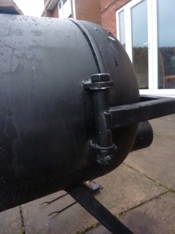

Door hinge.

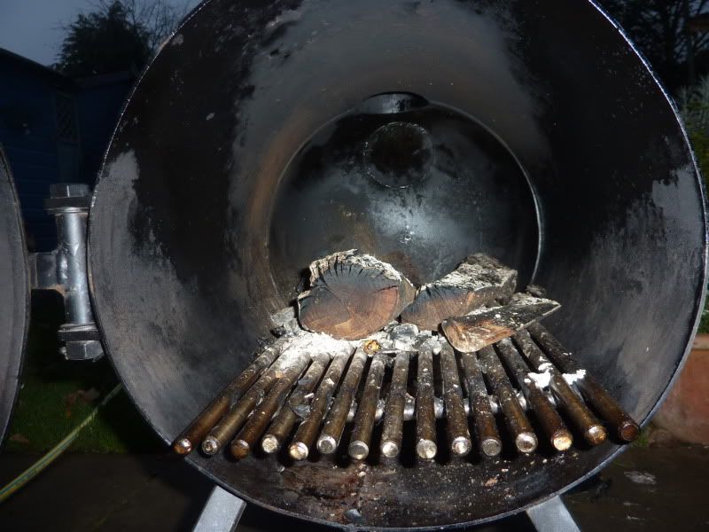

Firebox

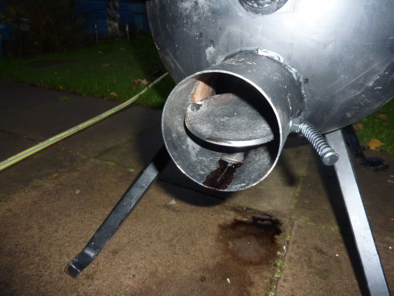

Air inlet valve

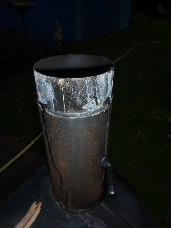

Outlet stub
Sooty in there!
Door hinge.
I've had two burns now and my thoughts are as follows.
- The firebox is a bit too big (700mm long domed-end-to-domed-end and about 450mm dia-ish) and doesn't get anywhere near hot enough to support proper combusion. I think I might shorten it by about 4-6 inches.
- It needs a baffle! Most of the heat goes up the flue.
- I don' think the flue is large enough (4inch/100mm dia), probably needs 5 or 6 inch.
- The air inlet I think is OK, I enlarged it as I found the fire flared when the door was opened, even though the air vent was fully open.
- I'm changing the door hinge as that one is too ungainly, and at the same time may rotate the door 180 degrees so the air inlet is at the top as everyone says you need a top air inlet for wood burners as wood burns top downwards.

- I seem to have wasted my time wedling up that grate as all the info I've read says wood burns better sat on the floor with some sand to protect the steel from the heat, so it may well be removed and recycled for a future project.
