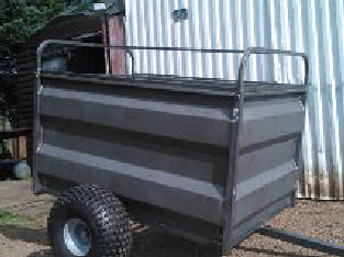

Wee pic of my latest version of ATV stock trailer.
hopefully a demo model for a well known local ATV specialist. it also gave me the chance to try out my new JMR 1000 tube bender-well recommended by the way-to fab up the removable roof canopy.
basic specs are 1.5mx1mx0.8m body size, 1.5mm steel sheet profiled and seam welded to 40x40x2.5mm box uprights. 50x50x5mm box axle beam and 50x50x3mm drawbar. max carrying capacity 500Kg. its now away at the galvanisers. 2mm aluminium chequer plate will be used for the floor - long lasting and can be easily cleaned/disinfected during lambing time.
