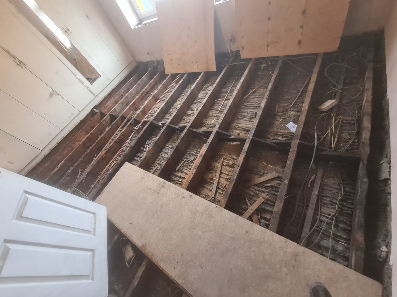

Plasterers took an eternity, mission creep led to a few weeks work not a few days, plaster the bedroom ended up like this. Take down and replace two ceilings, remove plaster and board over the whole stairwell, hallway, sort out various damp issues. Luckily i had a very good year last year and was able to get the whole caboodle done properly.
they left a few days back so I tore up the floor boards. I was scared to death of tis as I watched them take out all the floors and joists next door. But mine were all ol

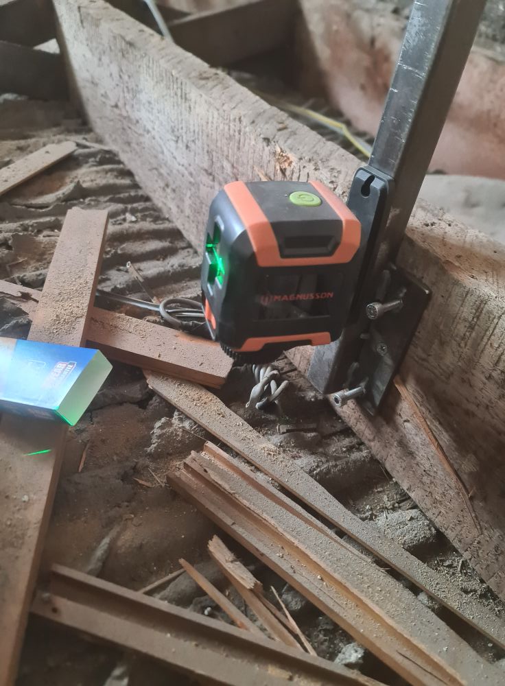

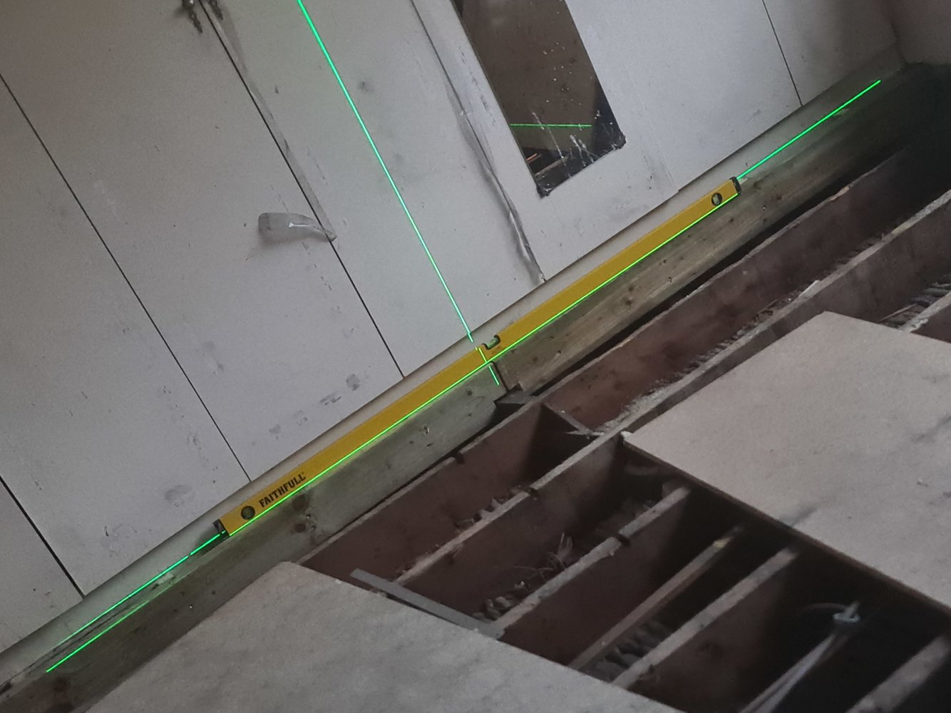

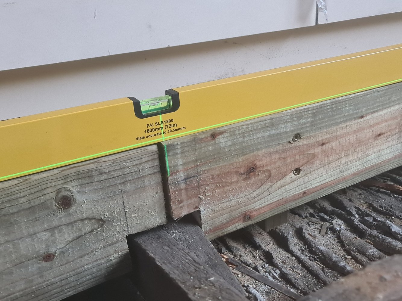

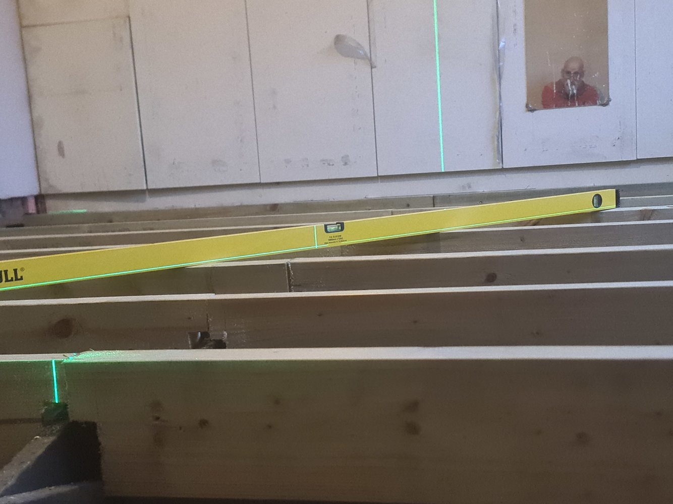

So next job. Noggins across the front of the wardrobes then fit the first joist to get a level prior to sister the rest of them.
A right pain but no 1 is level to within about 2mm over 3.6m. Cheapo laser did it's job perfectly.
Floor up
I made a little mount for the laser, the bolts are to level it up if needed
This made me a happy bunny
The floor is level well ok the first pair of joists
Floor was out by 100mm across the 3.6m wide room
