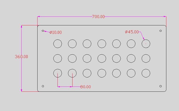

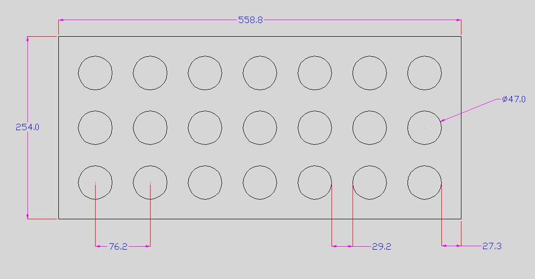

@Paul. So it will fit in the draw, so could we add 6 10mm holes
2 in each corner and 2 at mid point, I'll let you be the judge for best distance in.
The feet are likely to be some plastic posts 20/25mm OD with 10mm stub on the top (push fit)
Once i have the sheet i can then expirment with feet lenght to ensure clearance etc.
would you be able ? to punt it your mates way to see if its a doable by him and get a base price, in i think the consesus was acyrlic (8 or 10mm thick)
Philip
Philip
