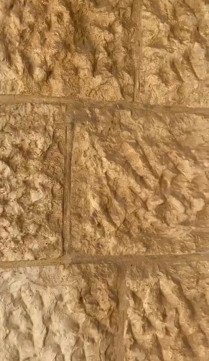

Currently, I am in deep search of laser cleaning machines, where I am looking for a laser machine that can clean buildings' facades, which are made of stones (attached picture).
And I got lost between Chinese people (they are really cooperative, but I just can't deal with them) and I need someone who has done this cleaning method.
Now I don't know what type of laser is required to handle the job is it CW or Pulse? remarking on the high price difference between the two laser types
(CW from 8K up to 12K) / (Pulse from 14K up to 55K) depends on laser power.
Therefore, I am seeking your help!
As I understood CW is for non-heat sensitive materials (as it generates heat to the cleaned surface), so can it do the job?

- High efficient speed cleaning, as we will cover large areas, a typical Jordanian building is made of stones and their facade’s area is around 240 m2, and it consists of 4 facades, thus 960 m2, so we need to be competitive with other cleaning methods (Sand Blasting, Dry ice blasting, or Water Jets).
- We will require an effective cleaning speed greater than ≥ 50 m2/h.
- An effective fiber cable length greater than or equal > 30 m.
- An effective cleaning width greater than or equal > 20 cm.
