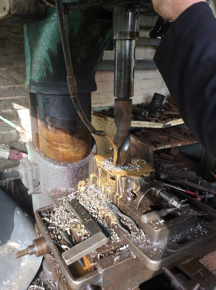

I have a 3' radial drill and drills to 2 1/2" dia. so yes I doo...How often is this practiced now?
2&15/32” on the Kitchen & Walker,some replacement motor mounts for ongoing alterations on a prototype.View attachment 386211View attachment 386210
