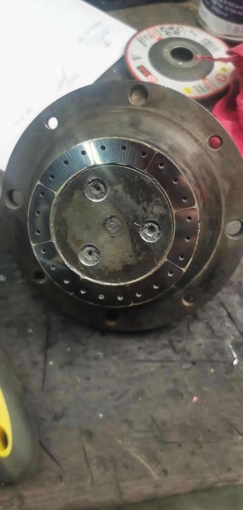

After grinding, some traces of the abrasive wheel are visible on the die. Hole ring - soldered tungsten carbide plates. I believe that the surface can be leveled with diamond paste to the level of a mirror. Manual lapping.
Q: With which face should I choose cast iron lapping plate? With a large notch, with a small notch, smooth? What grain size you need to buy diamond powder (how many grades to change sequentially).
Dia 88 mm
Dia 88 mm
