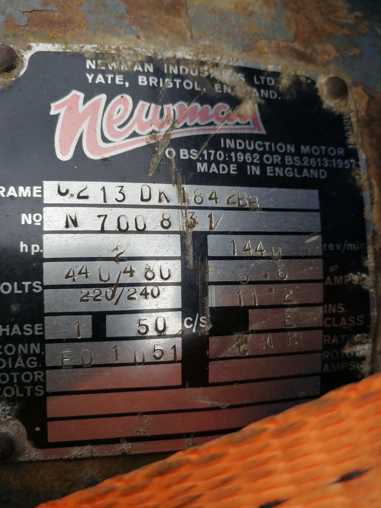

It's quit frequent in places that have three phase electricity. I had a welder that would work on three phase that used only two of the three phases, wired like two legs of a star, the result is the same as a single phase at the three phase voltage!Must admit single phase 440v threw me
