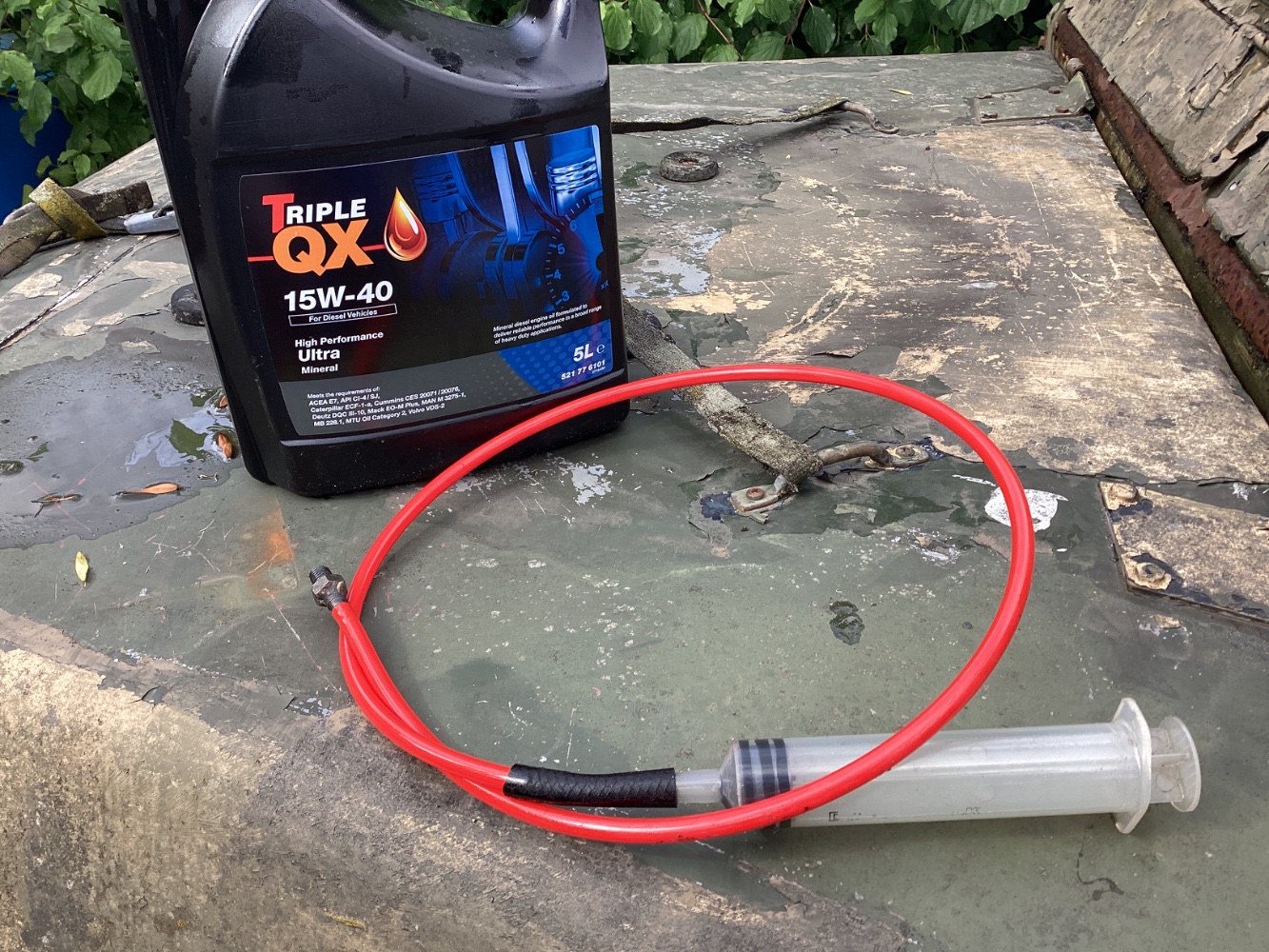

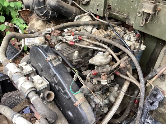

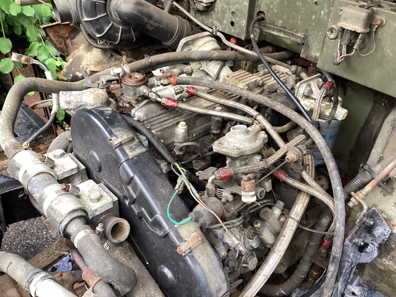

I have to move in the not to distant future, and I will need a car so the sorned in 2012 land rover has to be used. Or should I say resurected, it’s looking wirse the more I look at it. It will be my rainy weather veehicle and to pick up bike parts n such, oh and to move all my treasure. I was quite surprised the motor turns over, I was expeciting to have to put a Cummins in it. So oil change n clean fuel and I will see if I can start it. Tanks are full of crustyness n oily goo, so will run it from a can until I clean the tanks. Put a new oil filter on and drained the old black goo. Decided I needed to put the oil into an oil gallery, with a mind full of the pressure vessel i was going to make from an old fork leg, and blow the oil in half a litre at a time. So i made the fitting to go in the T piece the pressure sender is in, and take a bit of nylon tube, then realised I could just stick a syringe of oil on the tube and put the oil in 60cc at a time! 8x6 is well a **Language** of a lot of syringe fulls of oil, well 500/60and oh well I don’t need to know. But probably as quick as making something.
Once engine runs I guess I need to put rad back on, fill with water and see if head gasket leaks. Before I took the rad off I found a can to save the water n antifreeze in. I pulled the top hose off and it was dry as a dry thing.
