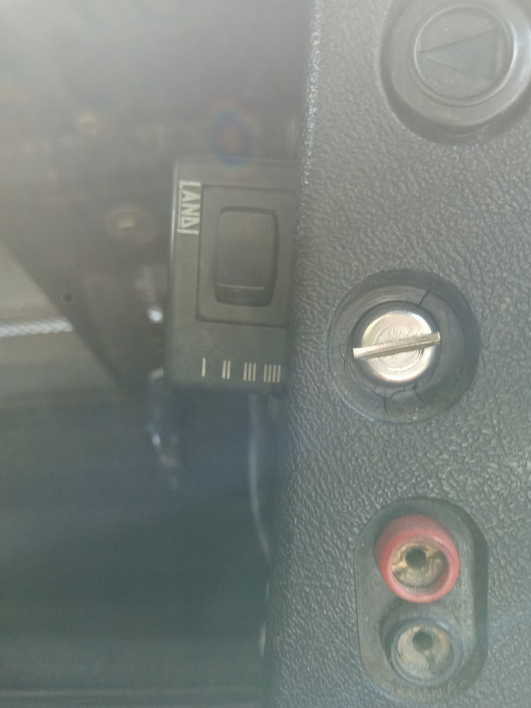

You have a v8?LPG change over switch.
Bob
Pic pics. BTW, Landi is short for Landi renso, not landrover...Thanks guys. The tank is still there though as far as I know not connected.

Well there's the old type, intended for carburetted engines, where the vaporiser provides gas at just below atmospheric pressure. the carb(s) need to be fitted with venturis - badically restrictor rings, with gas supplied to the inside of the ring, holes on the inside edge, all around. Engine air is sucked throgh the ring, low pressure created inside the ring, sucks the gas in. If I recall I have a v8 kit here. This type needs the petrol pump to switch off, carb empties, driver switches on the lpg solenoid. They were prone to causing inlet manifold explosions with weak mixture backfires, loss of engine power due to the restrictors and the lpg giving slightly less power.
The gas injection type - piggy back ecu, "reads" the cars injector signals and fires a set of gas injectors (solenoids) one in each manifold leg. The ecu must also switch off the petrol ecu, so this type takes a bit of wiring. The vaporiser supplies gas at a much higher pressure. It also can be "mapped" to compensate for injector sizes, accelleration fuelling and switch on temperature. Both types must be fed with hot coolant via the heater circuit, sometimes this can be fraught with issues.
My MGv6 was a pig to fit due to lack of room for the vaporiser, and once fitted, the reccommended piping - parallel with the heater, which was converient, ran cold when the heater was on. I ended up piping it in series - many hours and skinned knuckles. Once fitted it worked well, the two issues I had over 6 years - gas solenoid coil went o/c, and the vaporiser diaphragm holed itself. Oh, some engines need a valve saver to protect the valves from picking up seat metal and destroying themselves. Luckily my kv6 didn't, 140,000 miles later it was still like new.
