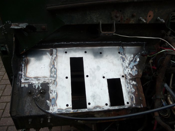

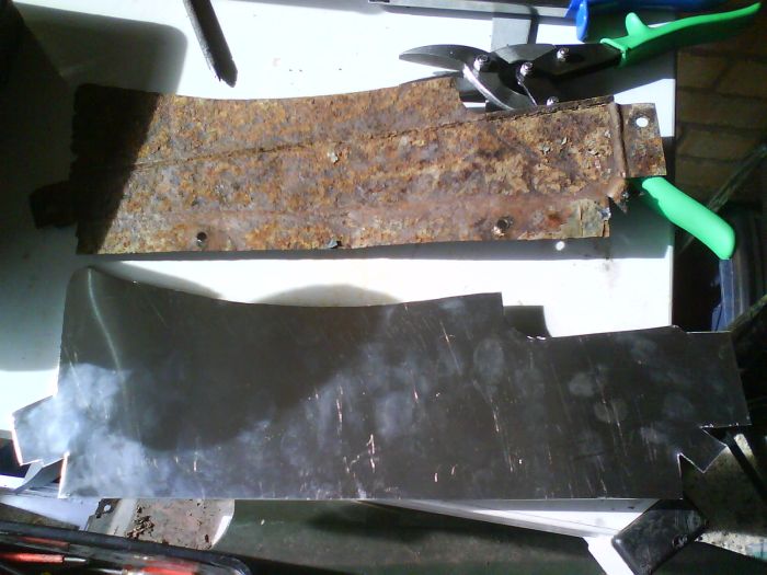

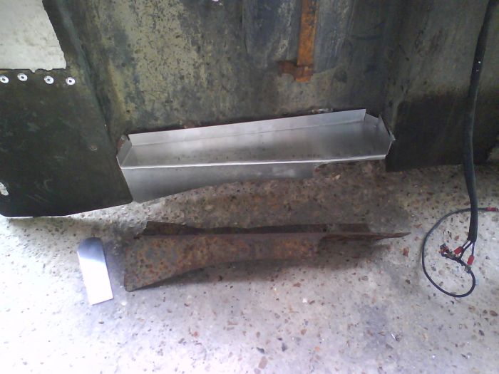

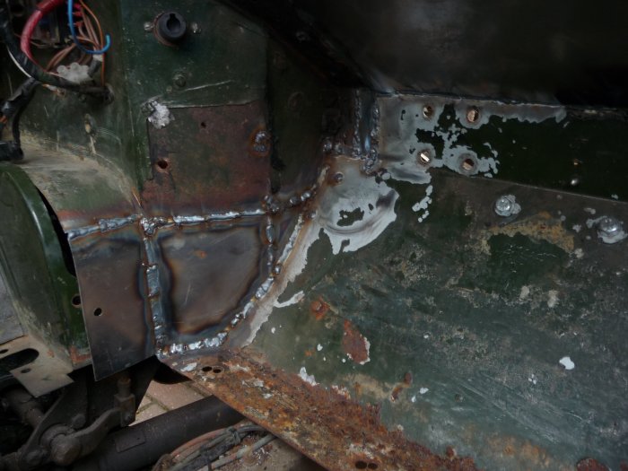

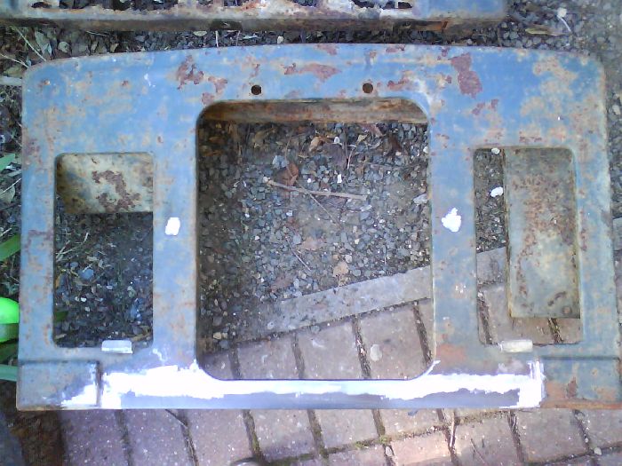

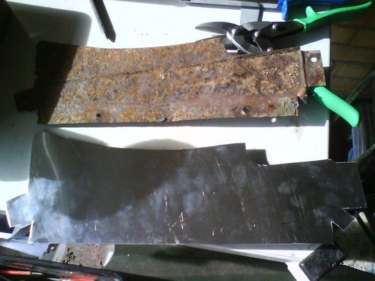

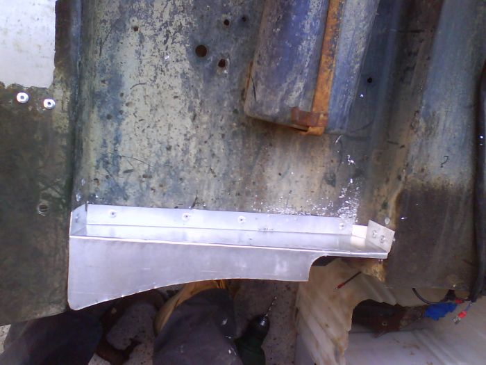

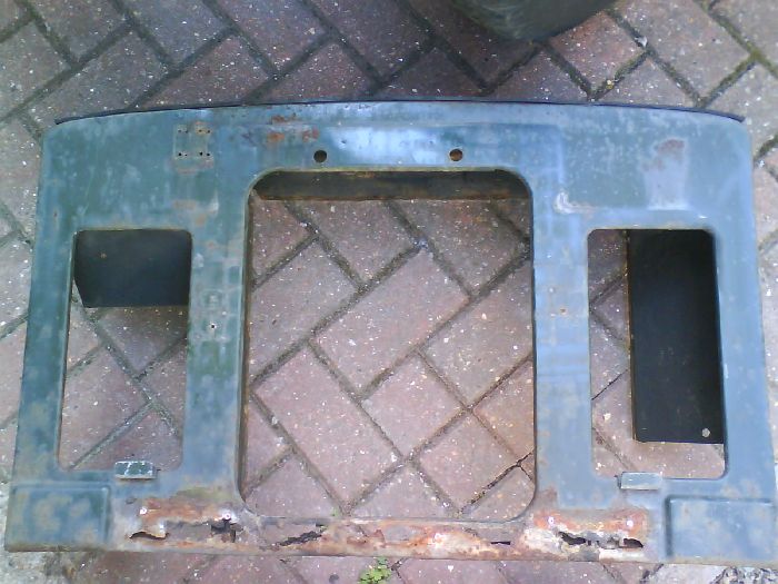

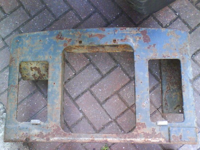

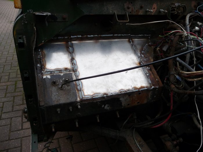

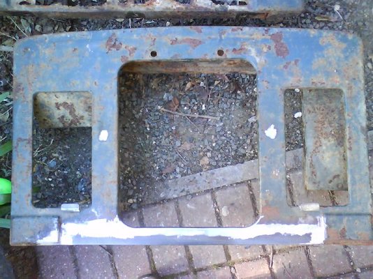

I was going to use ready made panels, but couldn't really afford them, this was half the price by buying steel, and it's thicker. And i've got loads left over! I bought two 4'x2' sheets of 1.2mm, and only partly used one of them.

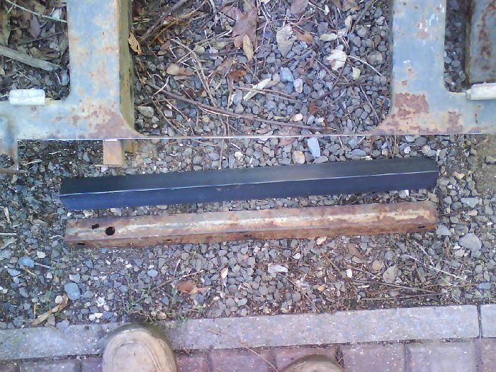

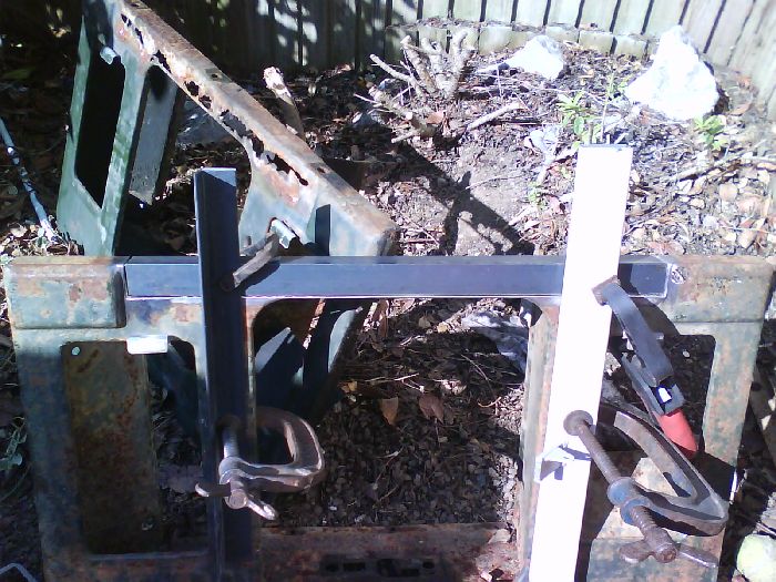

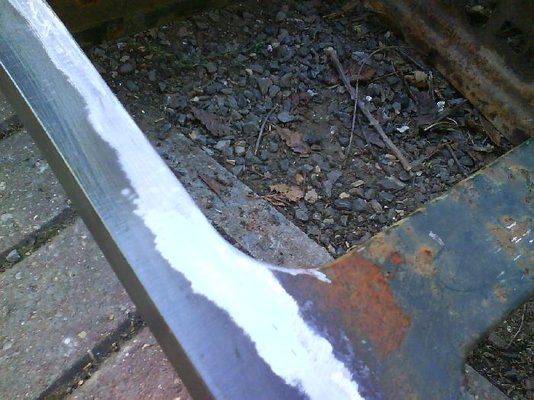

I've not seen front panel repair panels. Shouldn't be too hard. The rolled edge on straight bits could be made from sheet folded first then welded in as I did with the angle iron. The rolled edge on the corners could be made with thin strips of steel bent around a piece of tube then welded on separately.
