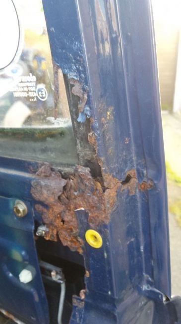

Rear drivers passenger door
Started like this after some poking

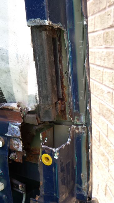

After a bit of cutting

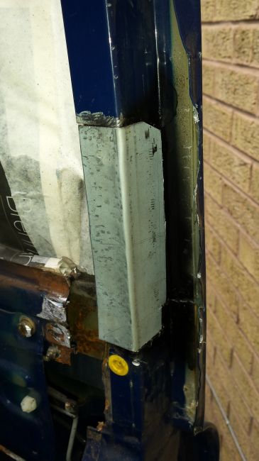

Inner part of the frame fitted
Repair section cut to fit

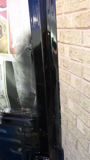

The door has since been painted, but I have notice a weld didnt take so I need to flap disc down, re-weld and re-paint
