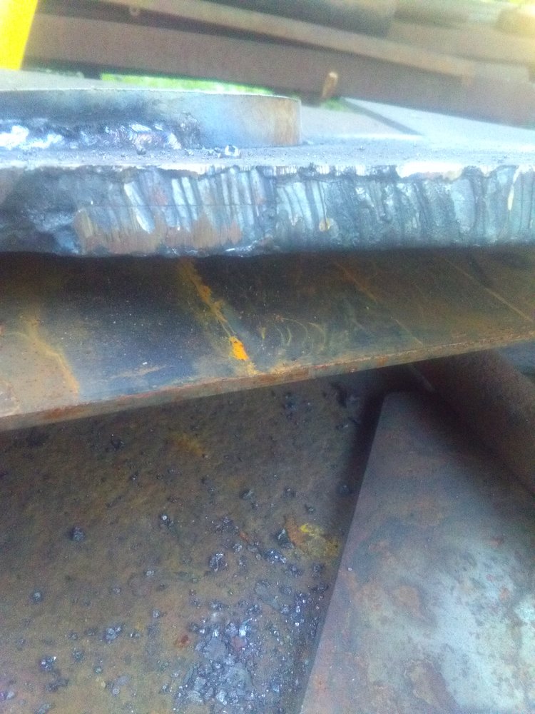

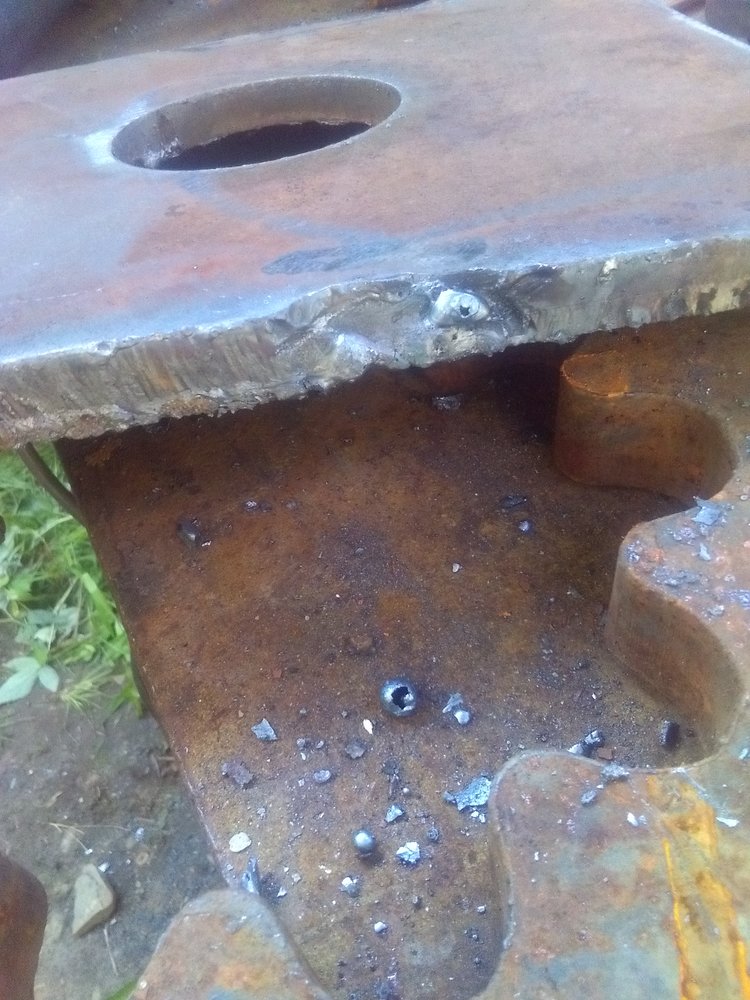

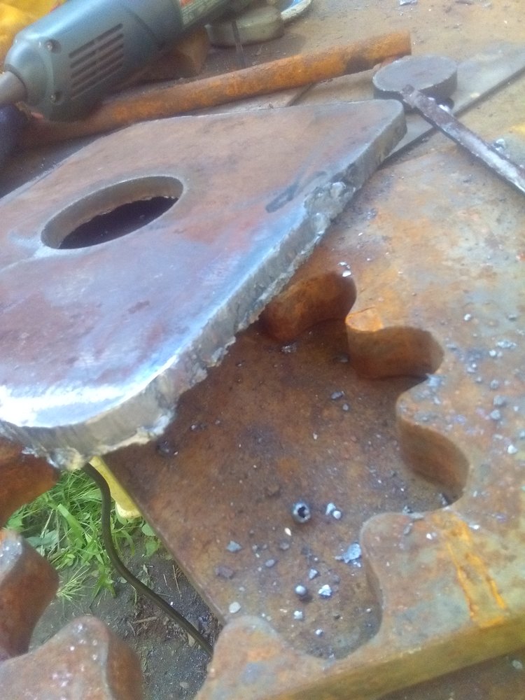

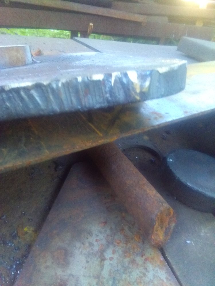

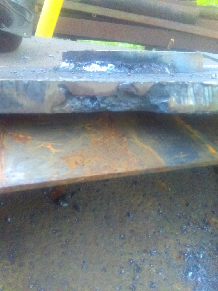

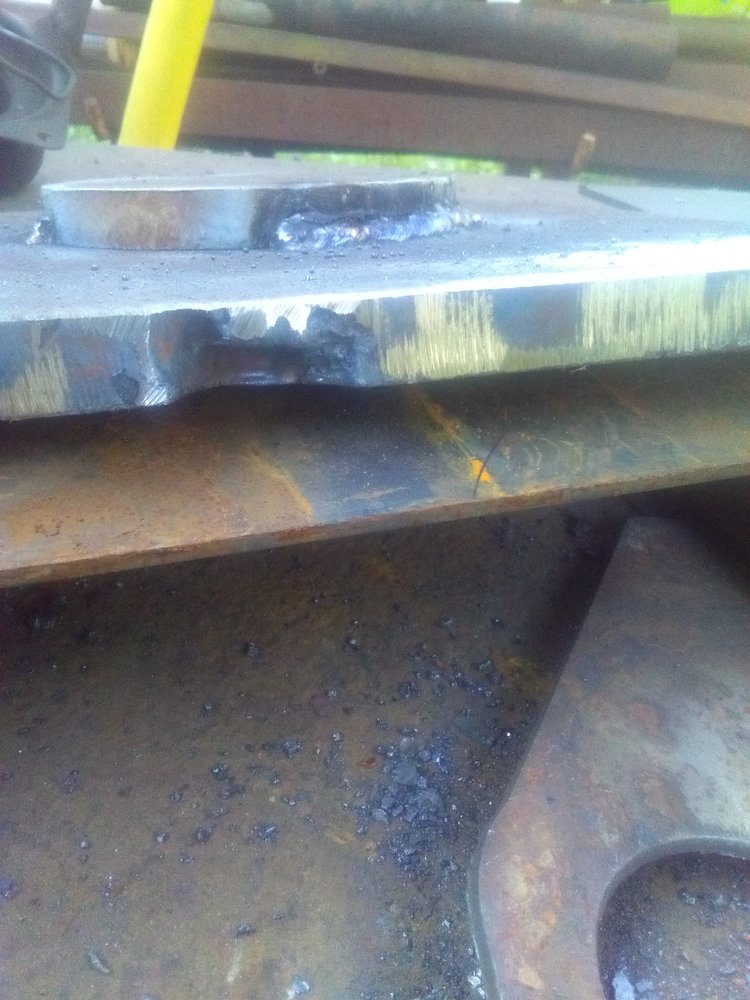

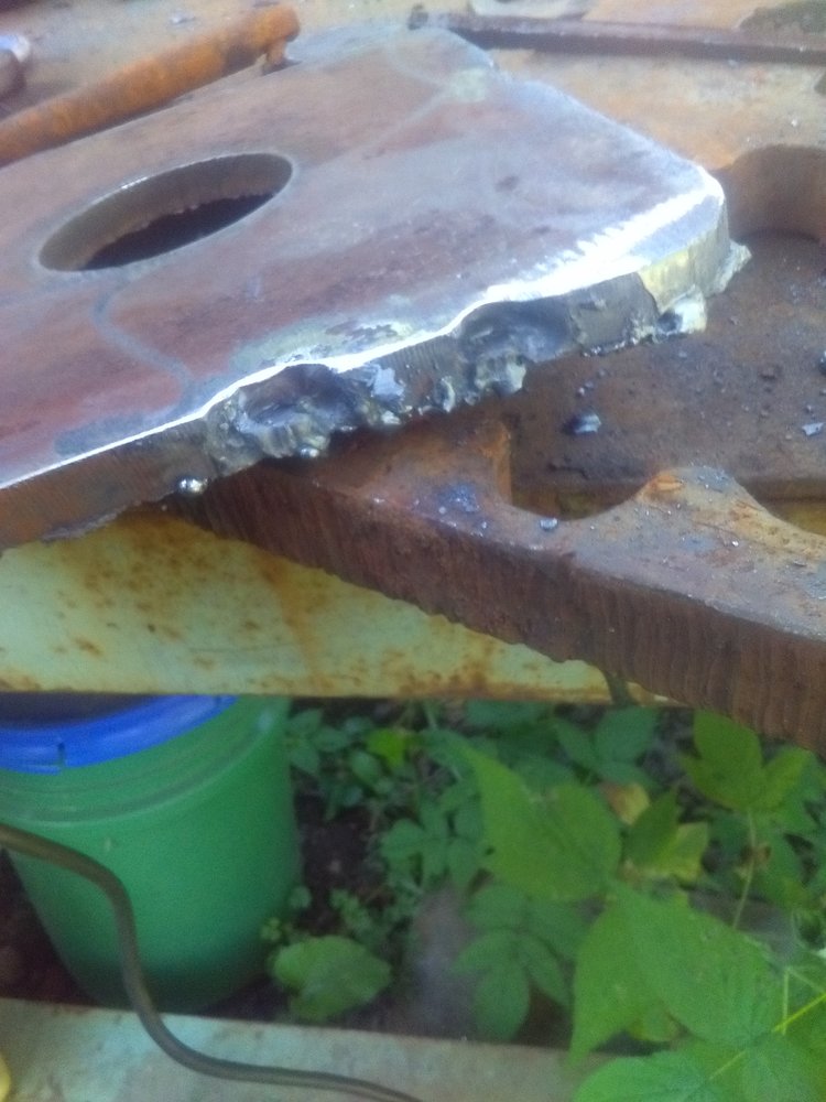

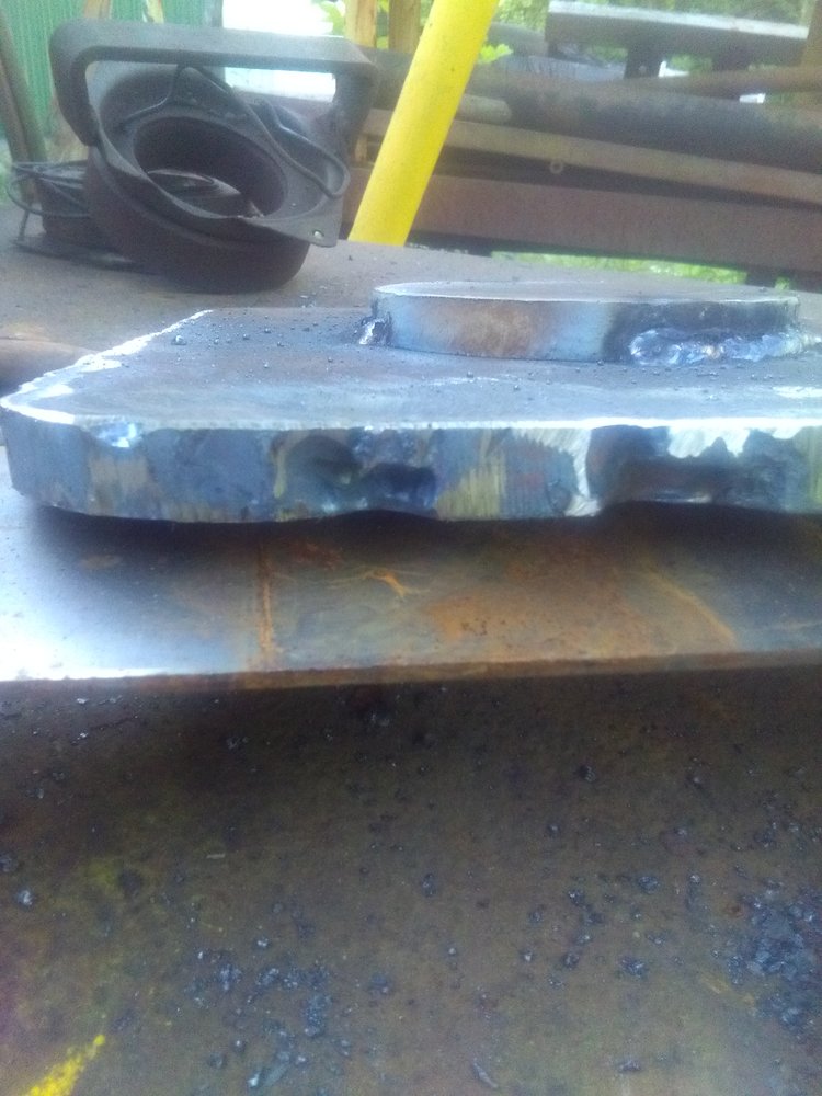

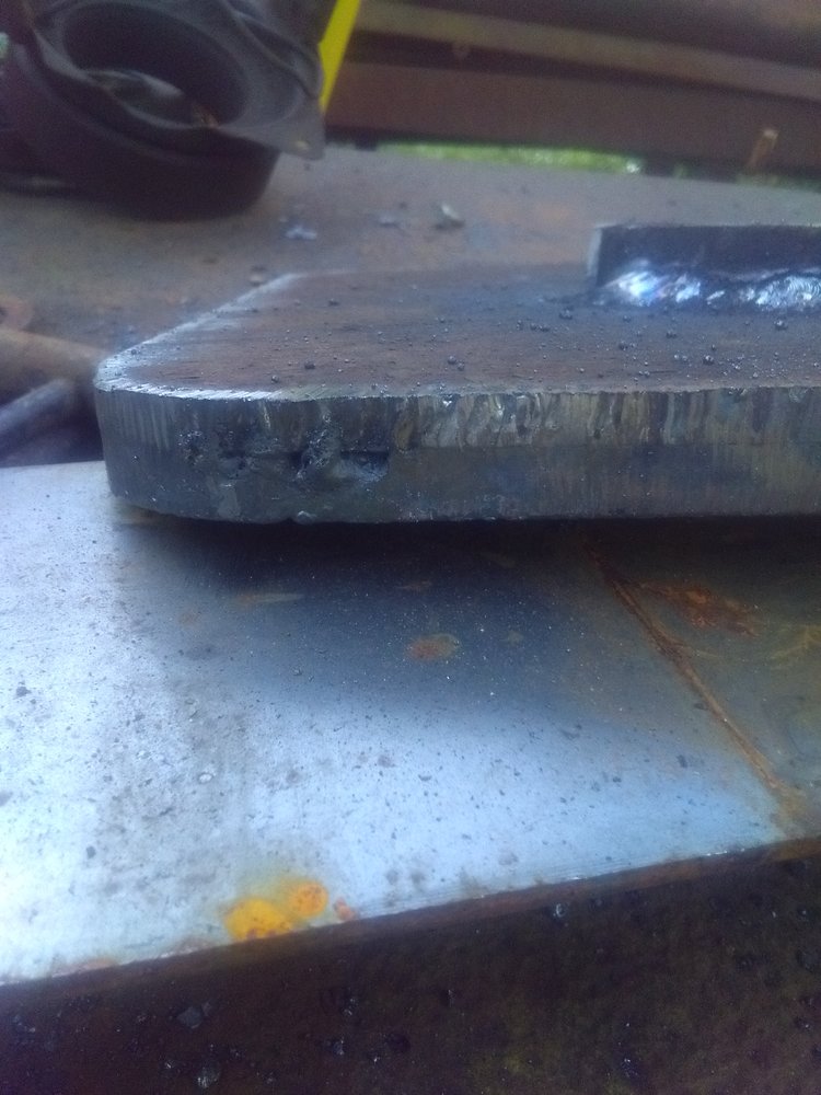

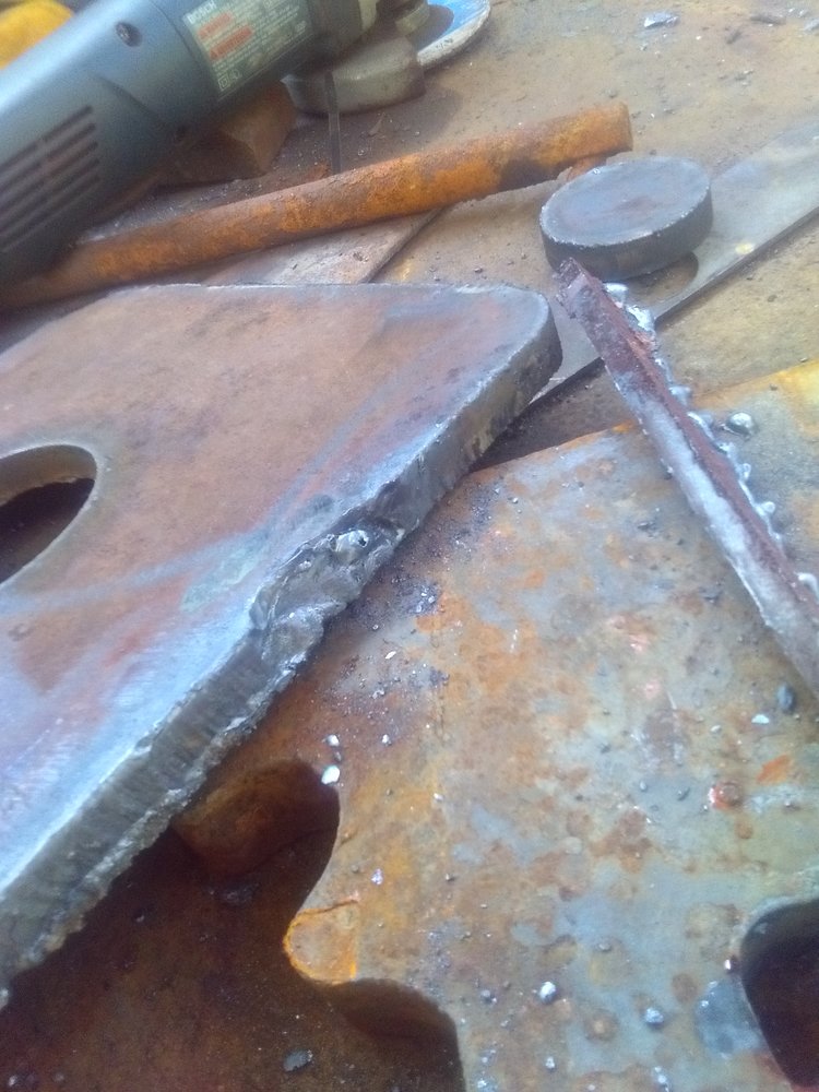

Fired up my CNC Table to make a column base for the house.
Put the new Oxy torch on, no problems.
The plate was a well used scrap I had of 1/2" thick, I adjusted the base size
to fit in the available area.
Burnt center hole just fine, along the first side of the outer square, had problems, but re-started cut, and continued on.....2nd & 3rd side o.k. coming down the home stretch, major problems,
blowing slag all over the place, I shut it down.
Next day, I
I took a straight edge, and re-cut that line by hand, it took quite allot of manipulating
to get a cut.
Ground off the junk, and lo & behold, the crack can be seen.
