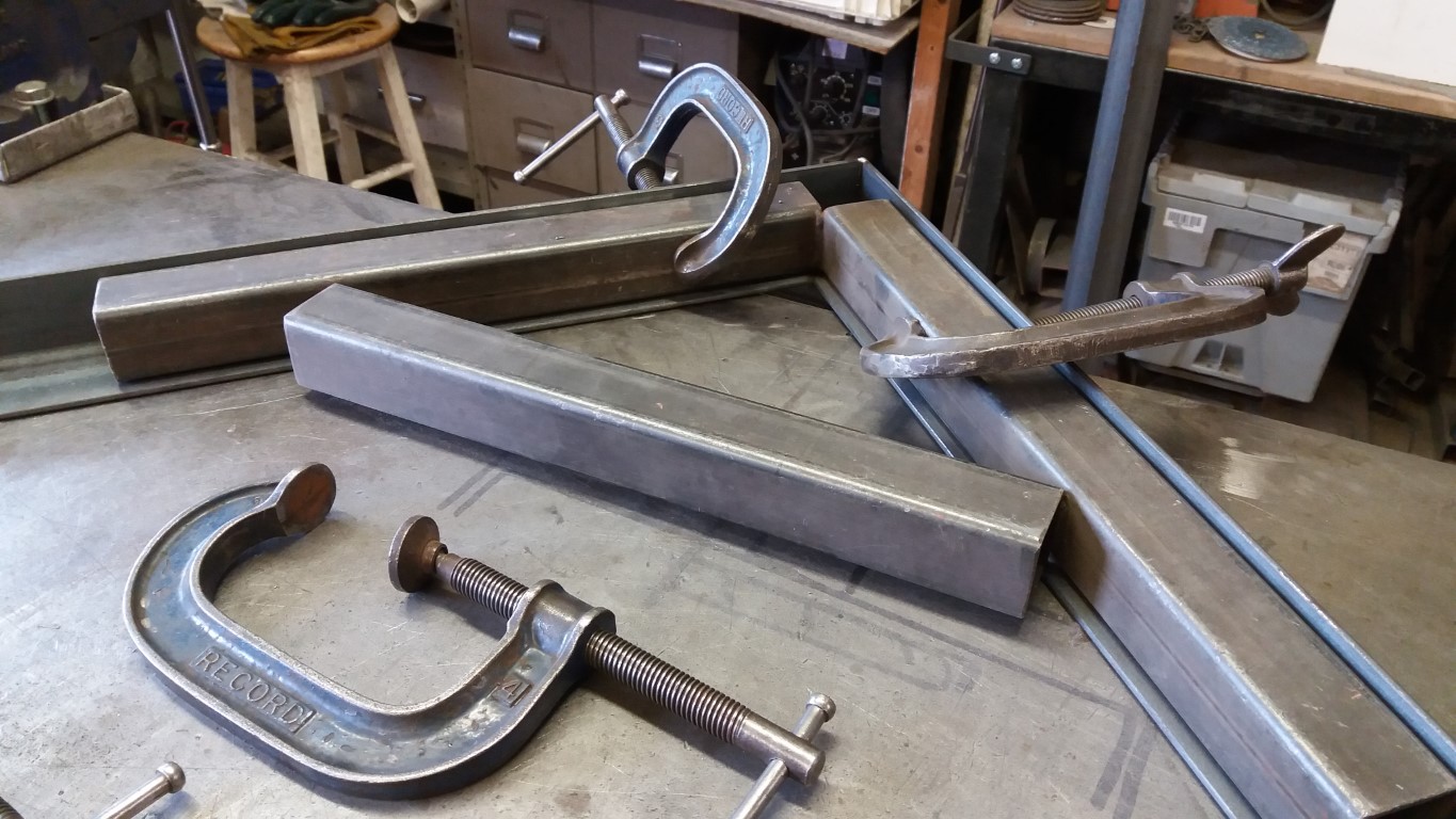

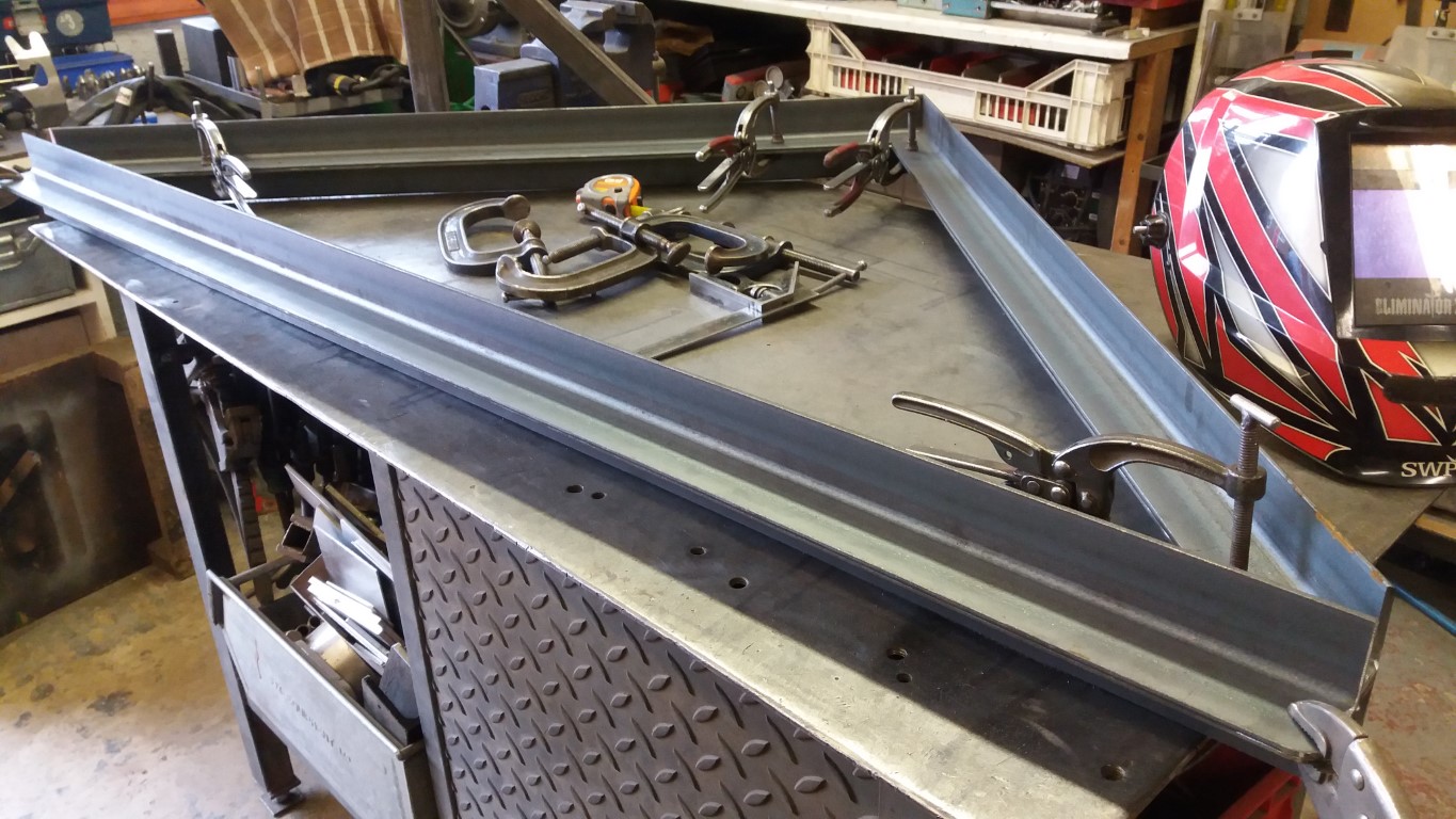

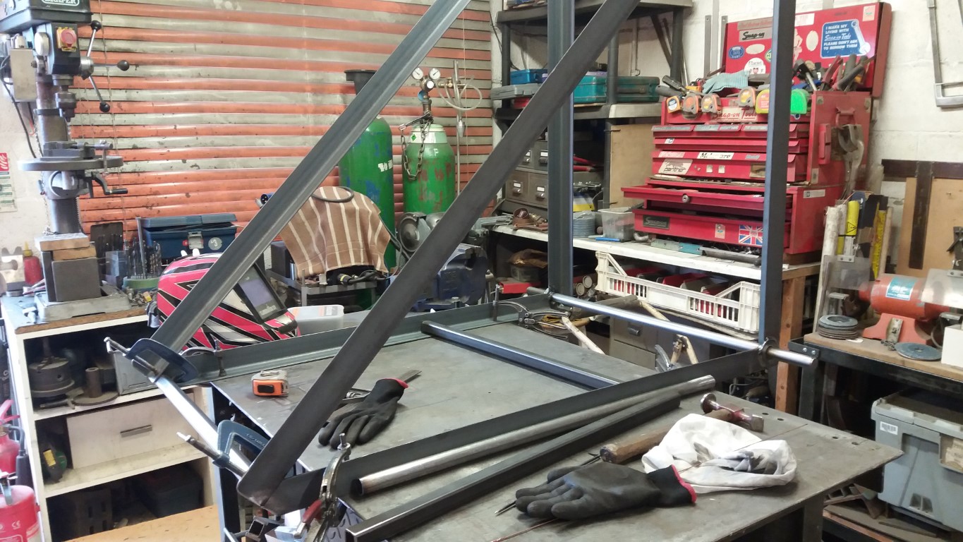

For the local fire brigade workshops, trollies for handling ladders, all mild steel migged together.
Fabbing them up using my trusty squares,
Build one frame then use it as a jig to make the others
Getting bigger

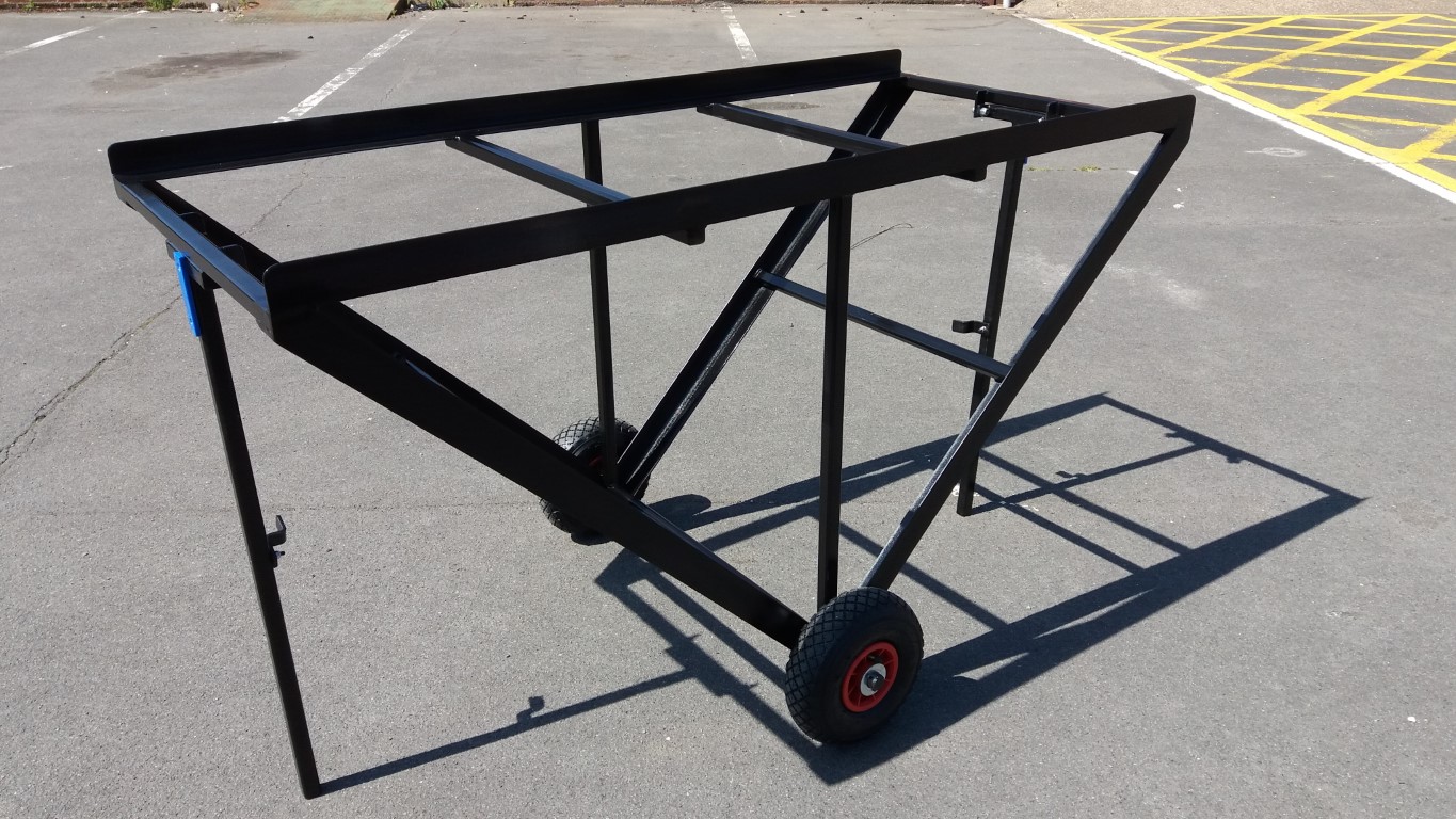

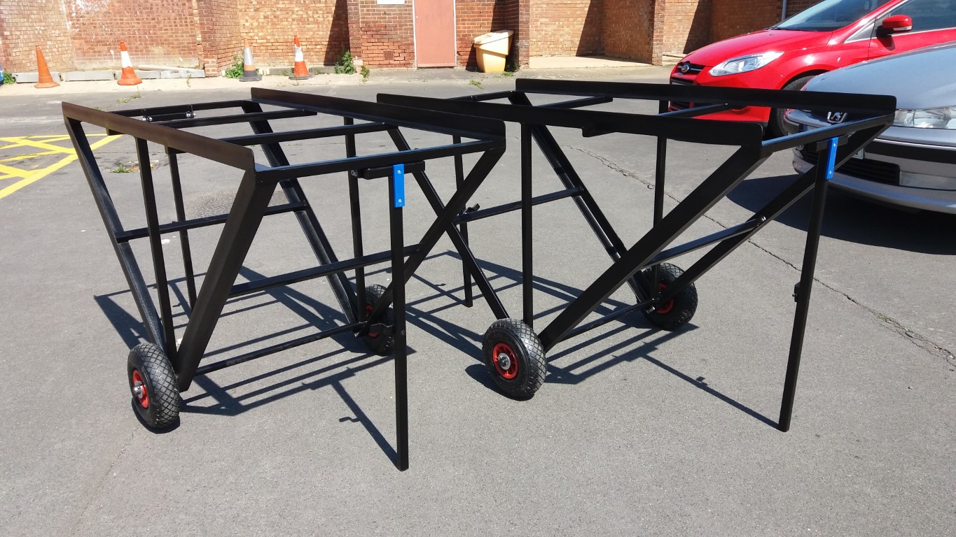

Finished job, quick coat of paint and fitted with 10" pneumatic tyres for use on rough ish ground, and a folding leg at each end to hold them up while being loaded
Folding legs at the end retained in the up position by a simple rotating catch
And ready to be delivered, just the paperwork to do now
