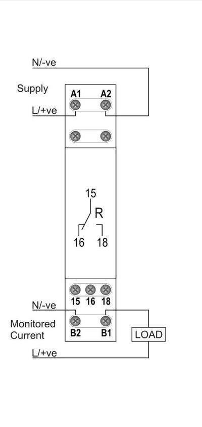

So, I do a bit of mobil catering, we are fairly well sorted with a power distribution system to break down out from anything upto a 63a outlet on a big site genny.
Most of the equipment we plug into the distro is normal 13a plugs although it's all pretty much 3000w bits of kit so pulling the full 13a.
An example of the problem,
Yesterday, we are running off of a generator with a single 32a outlet.
Kit connected:
Food warmer, 1500w, pid controlled.
Griddle, 3000w, mechanical thermost.
Induction hob, 500-3000w adjustable
Hand wash, 3000w, instant heating - you press a button on this and it pumps out hot water for 30secs. No tank, just an instant heater element inside.
So, 45a Total max load.
When setting up I can just turn on one at a time, let each warm up before turning on the next.
The warmer and griddle are then just turning themselves on/off to maintain temp and I can run the induction at a lower power if the other 2 are both heating.
However, 3 times yesterday the outlet breaker on the generator tripped when someone pressed the button for the hot hand-wash.
Mainly annoying because to save the noise I normally position the generator as far away as possible.
I'd like a lightweight, compact solution if anyone knows of anything?
I'm thinking of a box with one plug, 2 sockets. Plug the hand-wash into 'outlet 1' and griddle into 'outlet 2'. This would have a switching/change-over contactor inside.
When it detects a load on outlet 1 it disconnects outlet 2 until outlet 1 has finished.
However, there must be some sort of control circuit inside the hand-wash so I'd need outlet 1 to be live all the time to power that.
So, something like 'if more than 1a load on outlet one disconnect outlet 2'.
Something din-rail mounting that could replace a normal breaker would be ideal!!
