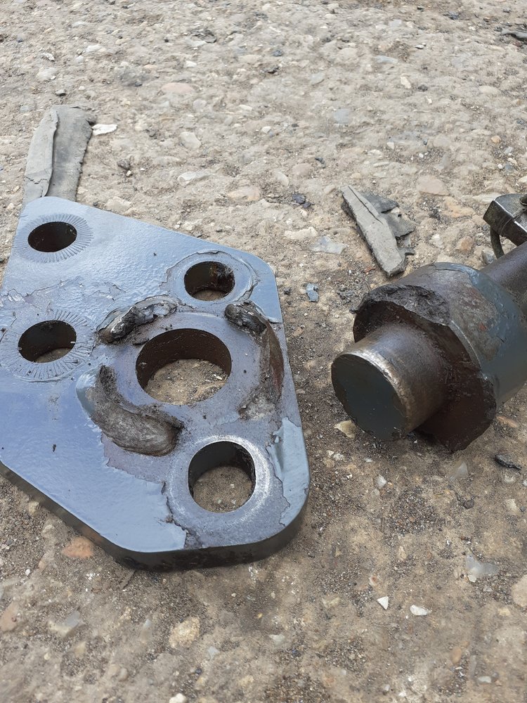

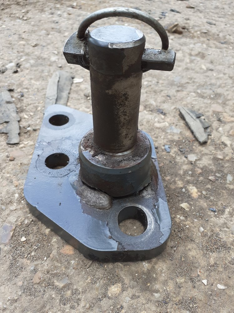

B Bornfree Member Messages 2,286 Location England Norfolk Jun 11, 2022 #1 This is the bottom linkage arm mounting on a 100hp kubota this has had a 2 ton straw chopper bouncing on it for 8 years surprising what a small weld will hold. The spigot is not even a tight fit in the hole.
G Guzrik Member Messages 724 Location Holland Noord Brabant Jun 11, 2022 #2 And not welded in the back?
C chris pruteanu Member Messages 1,026 Location ROMANIA Jun 11, 2022 #3 I weld many tractor power take off arms especially when the pivoting joints start being loose…they are abusing them and they hold and hold !
The_Yellow_Ardvark https://www.death-clock.org/ Messages 20,230 Location Going Away. Jun 11, 2022 #4 A Common failour on thjose tractors. They break before an expensive bit leys go.
